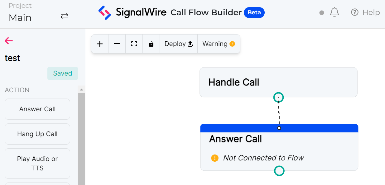

Start by navigating to the Call Flow Builder. Create a new flow, and name it something easily identifiable.
Handle Call serves as the default starting point for all call flows. Drag your first step below it - Answer Call is a good place to start. Make sure you connect the green node from the first step to the blue panel on the next step.
As your call flow becomes complex with multiple steps and options, the builder will alert you if a step is not properly connected to the flow.

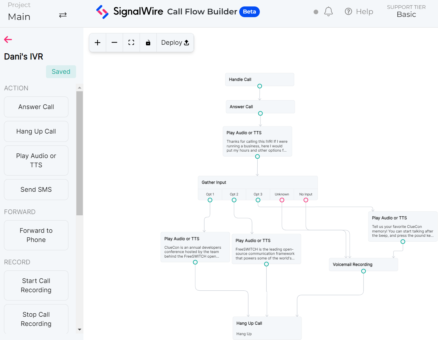

Step two: Gather input
Next, gather input from the caller, and explain what they have to do to reach their desired outcome. This simple IVR will have three options that will branch out to other text-to-speech recordings.
Typically, these options would route callers to various departments, like support, billing, or sales. Using the forward to phone option, you can route callers to the proper agent or department.
Define the options - this example will include three. Each option must link to the next step, whether that be voicemail, additional text-to-speech menus, or forwarding to another phone. Use the text box to describe options to callers. Specify the digit to press or say, and list the corresponding numbers.
In this example IVR, pressing 1 will give you more information about ClueCon; pressing 2 offers more details about FreeSWITCH; and option 3 will route callers to a voicemail to share a favorite ClueCon memory. For this basic IVR, this will be the end of the phone tree.
Continue mapping out more options, phone lines, or voicemails as needed. If routing to voicemail, consider adding in a brief snippet of text-to-speech to let callers know they can start recording after the beep or specify a response time.
Be sure to conclude your flow with the Hang Up Call option. Lastly, hit deploy to finalize the call flow.
