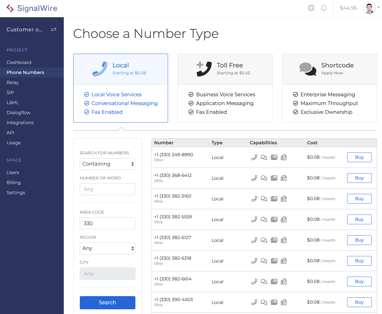

Next, you will need a phone number. Click “Phone numbers”, hit “New”, and pick a number you like. We support searching by area code and specific strings of text. I recommend starting with a local number.
