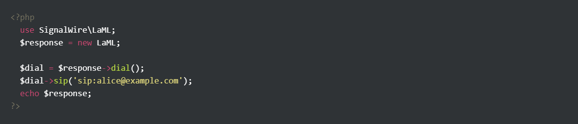

If you want to build an application with SignalWire services to tie into your SIP endpoint, programmatically routing SIP calls to SIP endpoints on the SignalWire network is equally as easy. Using Compatibility XML:
<Response>
 <Dial>
 <Sip>sip:alice@example.com</Sip>
 </Dial>
</Response>
<Response>
 <Dial>
 </Dial>
</Response>
<Response>
 <Dial>
 </Dial>
</Response>
<Response>
 <Dial>
 </Dial>
</Response>
Or PHP:
