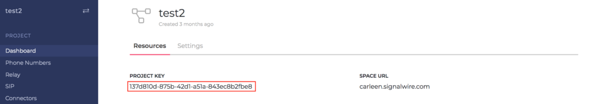

Use our demo application to test your configuration from your project. The SignalWire Call Demo can be found here. To get started, we need to grab our Project Key from our SignalWire dashboard:
Paste it in the SignalWire Call Demo under Project. We also need to obtain a JSON Web Token (JWT). To learn more about generating and using JWT, including all of the options that are available to you, see our Authentication for JavaScript SDK Documentation.
