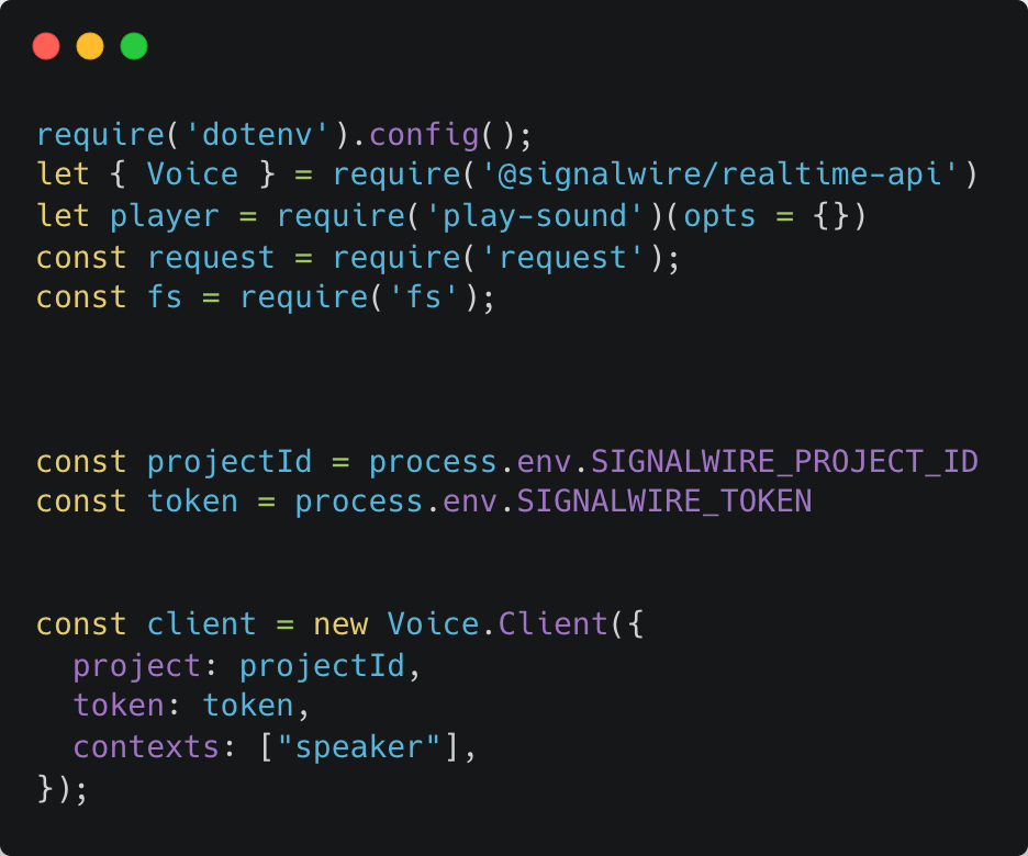

First, we import the SignalWire Realtime API and create a new RELAY voice client using the credentials from the environment file. We also set the context here.

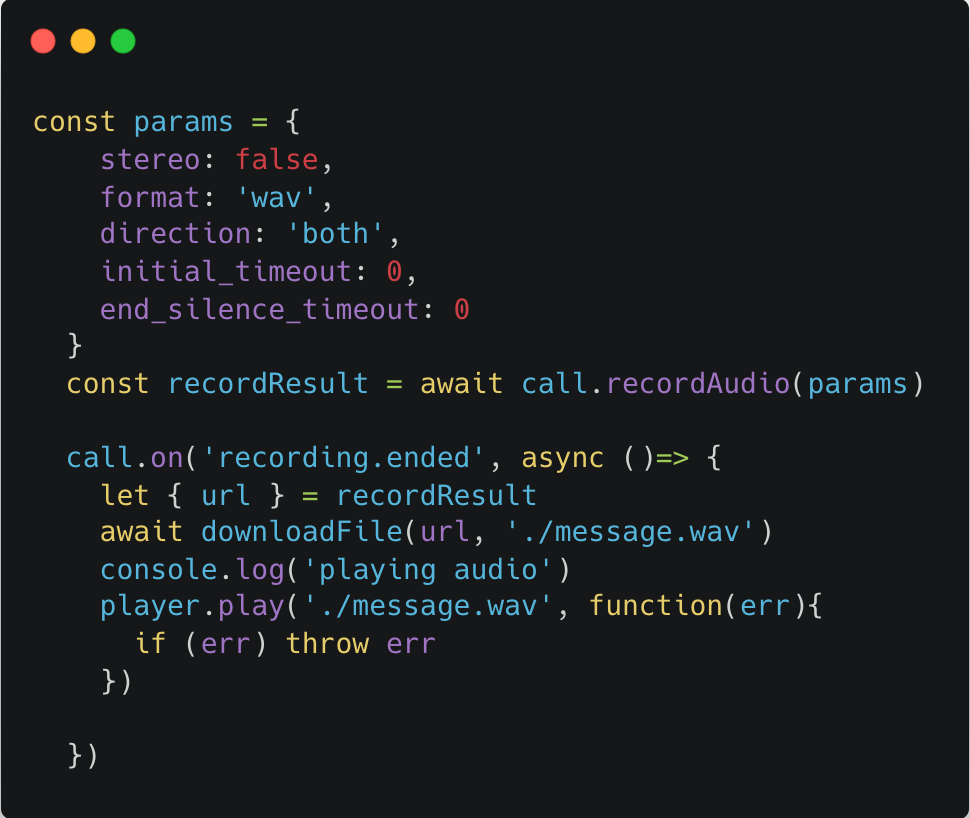

After playback has ended we initiate a call recording. We create another event handler for when the recording has ended, which can be triggered by the caller pressing the # pound key. When that occurs, we download the file and then use a third-party library to play the file.
