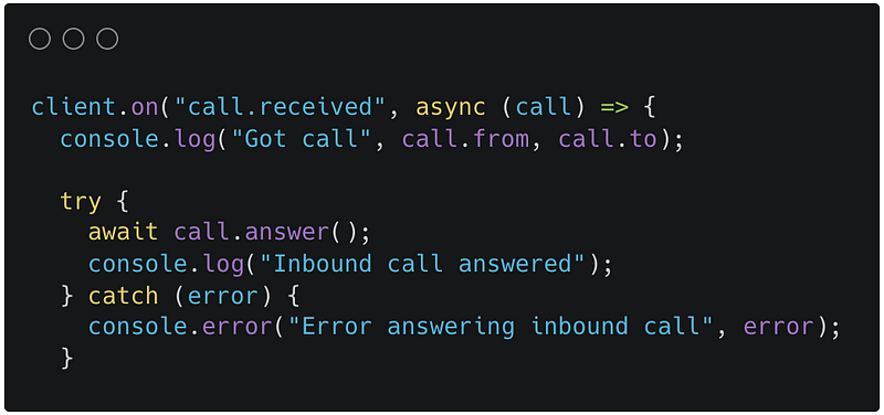

We then create an event handler for received calls. When a call is made to the SignalWire Inbound Phone Number configured to the context for this consumer, they will be passed to this function. Properties of the call are also available, such as call.from and call.to.

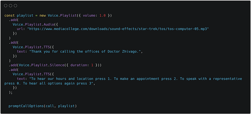

Create a playlist
Next, we want to play a welcome sound, take a pause, and read out the call options while we prompt the caller. One of the options is to hear all the options again and re-prompt. To reduce redundancy, we can use a feature of the Realtime SDK that allows the creation of playlists.
We’ve combined playing an audio mp3, text to speech, and silence into a playlist object. That playlist along with the call object gets passed to a custom function, promptCallOptions.

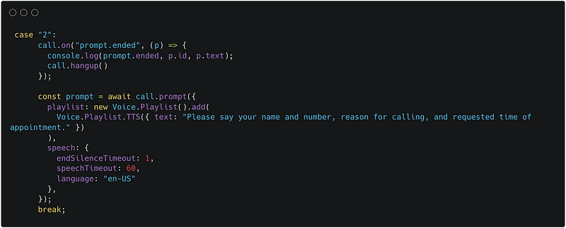

Option 2 is to make an appointment. Here we create an event handler for when the prompt has ended so that we can read out the result. Then we initiate a prompt using voice recognition by including the speech key. We set the endSilenceTimout to 3 seconds.
This means as soon as the caller finishes saying their name, number, and reason for calling, we accept that as completed input and the event handler will then read out the text in the console.
Once read to the console, call.hangup ends the call. Here you could modify the code to send the recognized text out as an SMS to a provider or call a third party API for making appointments in a calendar.

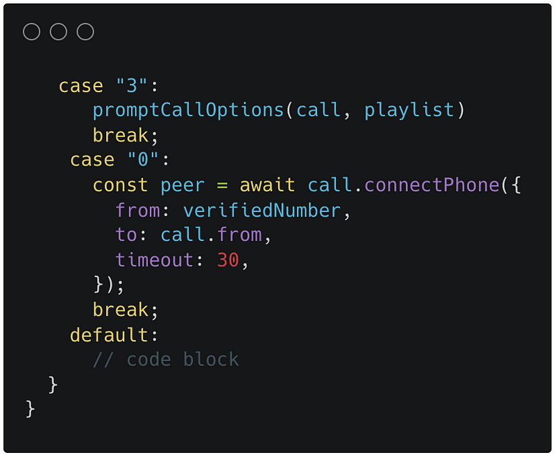

Option 3 is to restate the options, so we simply call the promptCallOptions function again.
Option 0 is using call.connectPhone to forward the call to a verified number. This can be used to allow callers to speak with a representative.

09
 case "3":
      promptCallOptions(call, playlist)
      break;
    case "0":
      const peer = await call.connectPhone({
        from: verifiedNumber,
        to: call.from,
        timeout: 30,
      break;
    default:
      // code block
01
02
03
04
05
06
07
08
09
 case "3":
      break;
    case "0":
        to: call.from,
        timeout: 30,
      break;
    default:
      // code block
