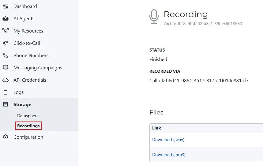

Confirm the recording worked
You can check Storage in your dashboard for the file, or query recording details from the Recordings API and confirm its status is finished. A no_input status means the recording captured no audio, and fetching its media returns 404.

View recordings from your dashboard
Recordings appear under Storage > Recordings in your SignalWire Space. Opening one shows its status, the call it was recorded from, and a download link for each available format.
The SignalWire Space sidebar with Storage expanded and Recordings selected. The detail pane shows a Recording with its ID, a status of Finished, the call it was recorded via, and a Files table offering Download (.wav) and Download (.mp3) links.
A finished recording in the Storage section of a SignalWire Space.

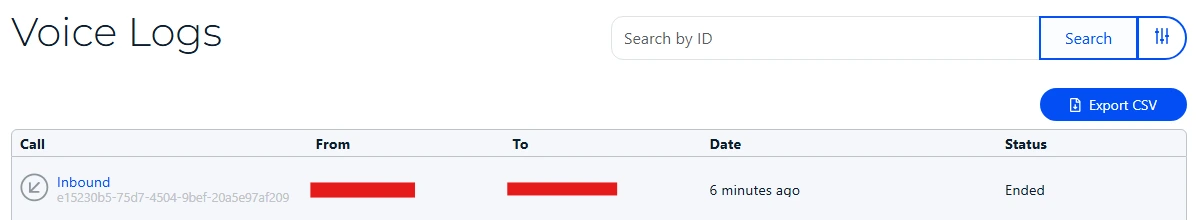

A call’s recordings are also listed on its log. Open Logs > Voice, select the call, and its details page shows every recording made during that call.
The Voice Logs page of a SignalWire Space, listing calls with their direction, ID, From and To numbers, date, and status.
Voice Logs in a SignalWire Space. Select a call to open its details page.
