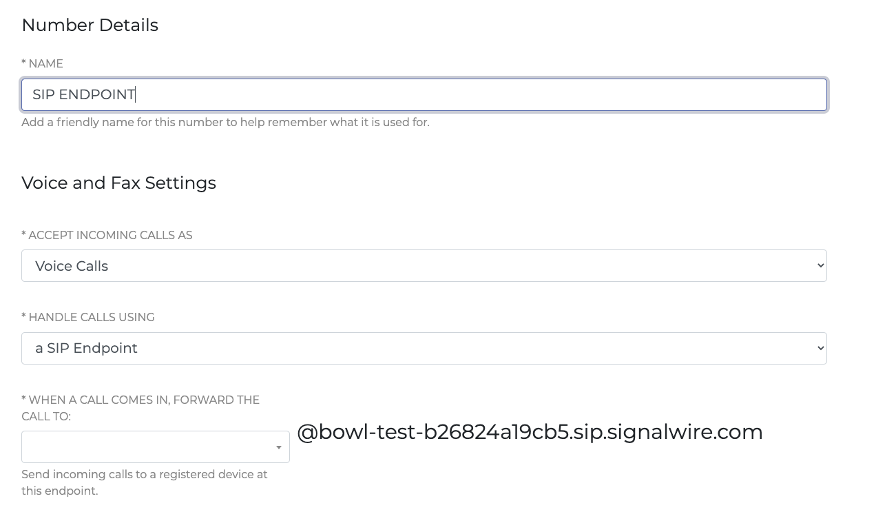

If you prefer to use API calls, you will need the Search for Available Phone Numbers, Purchase a Phone Number, and Update a Phone Number endpoints.
Change the Voice and Fax Settings to accept incoming calls as Voice Calls and handle calls using a SIP Endpoint. Then you can search for the endpoint by username.
After saving your settings, incoming calls to this number will be immediately directed to your SIP endpoint.
