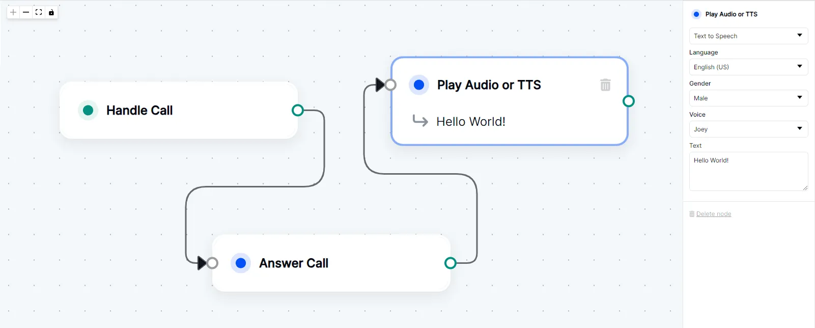

Handle inbound calls with Call Flow Builder
Build a Call Flow in Call Flow Builder, then add the SIP Address to it. In the example below, the Call Flow answers the call and plays a TTS message.
A Call Flow that answers the call and plays a TTS message

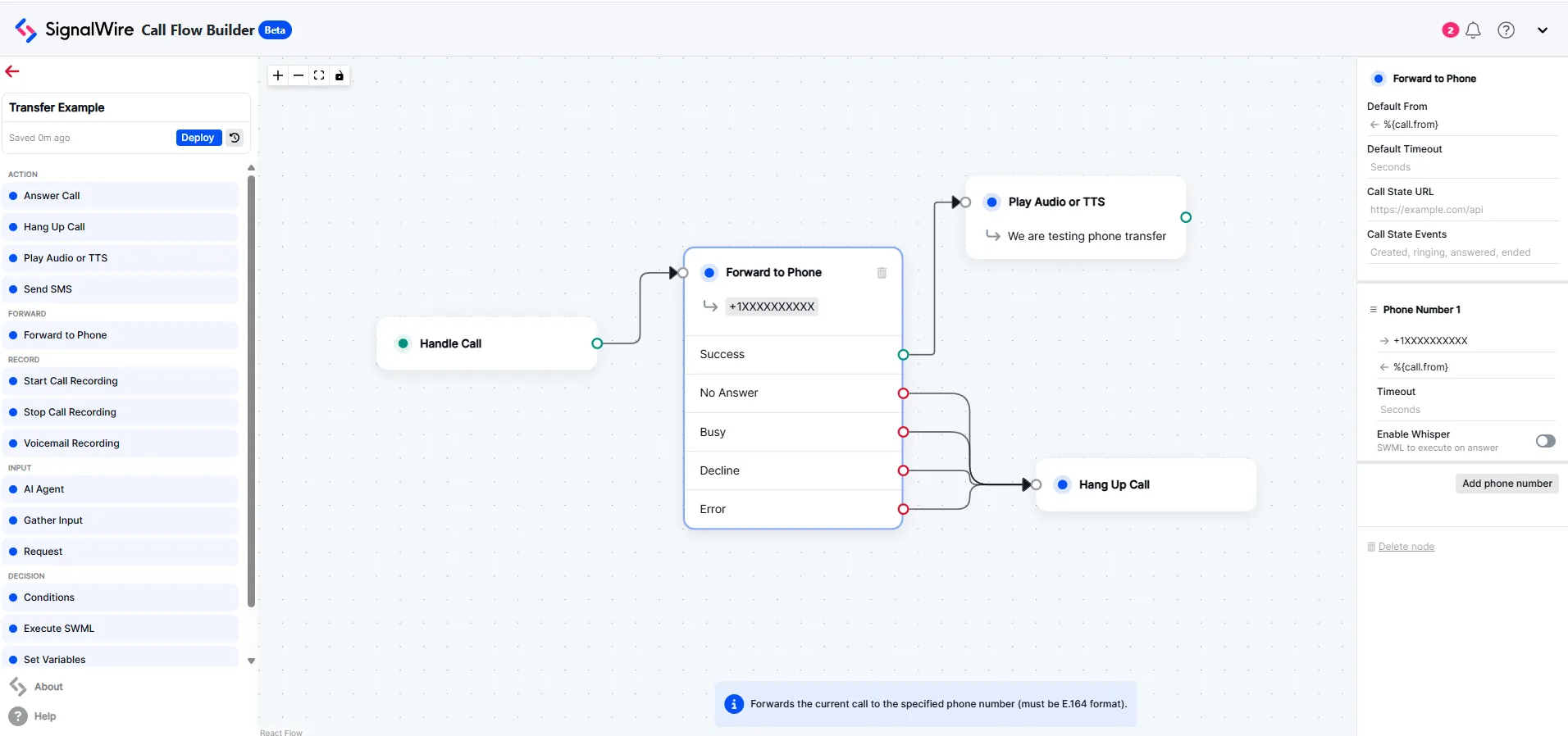

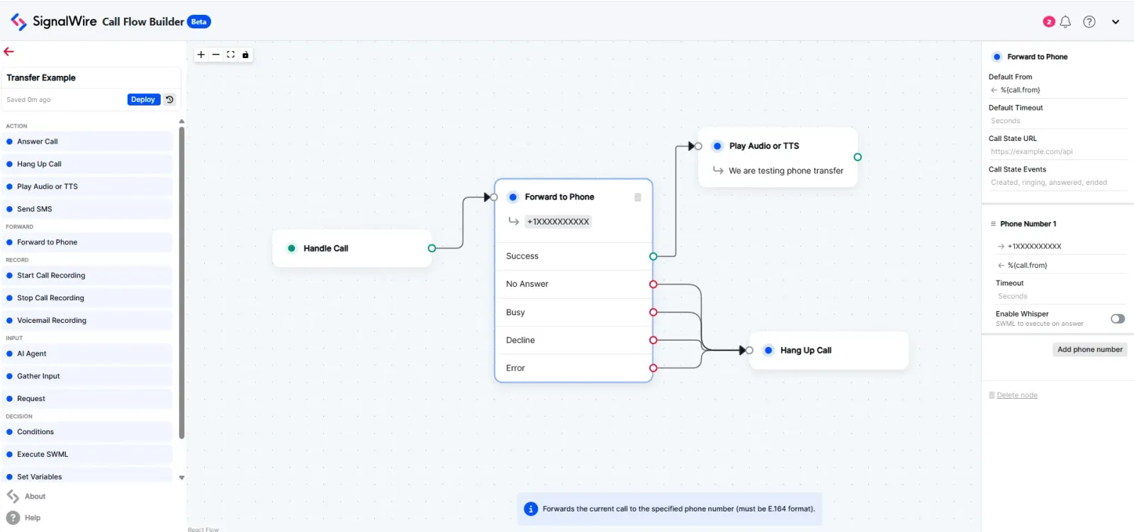

Dial your carrier with Call Flow Builder
To create an outbound call using a Call Flow, you can use the Forward to Phone node to dial out to a SIP endpoint:
A Call Flow that forwards a call to a SIP endpoint
