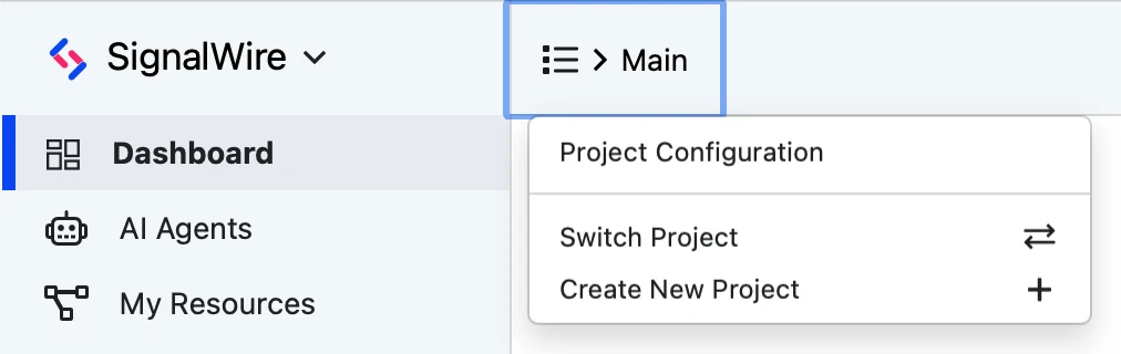

Work with Projects in the Dashboard
The Project name at the top of the Dashboard opens the Project menu, where every Project-level action starts: Project Configuration opens the active Project’s settings, Switch Project changes which Project the Dashboard shows, and Create New Project adds a root Project. A Project’s Project ID, Space URL, API tokens, and signing key are on its API Credentials page, which always shows the active Project.
Creating a root Project takes the owner or administrator access level. Any member who can open a root Project can create Subprojects beneath it.
1
Create a root Project
Open the Project menu, select Create New Project, enter a name, and select Save. The Dashboard switches to the new Project.
