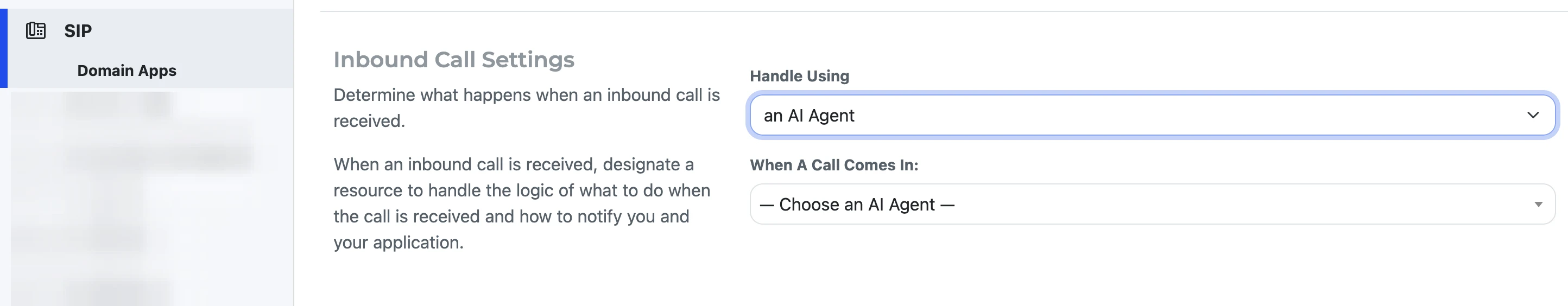

Add a SIP Address to your AI Agent
Once you have created your AI Agent, add a SIP Address to the agent’s Addresses. FreeSWITCH bridges calls to that SIP Address, and the AI Agent takes over every call that reaches it.
To add a SIP Address to the AI Agent from your SignalWire Dashboard:
  1. Open the AI Agent and select its Addresses & Phone Numbers tab.
  2. Select + Add, then SIP Address.
  3. On the New SIP Address page, fill out the Domain and Display Name, then select Create.
To create one in code, use Create SIP address. For the other Resources that can take a SIP Address, see Resource SIP Addresses. SIP Addresses explains the address format and its options.
