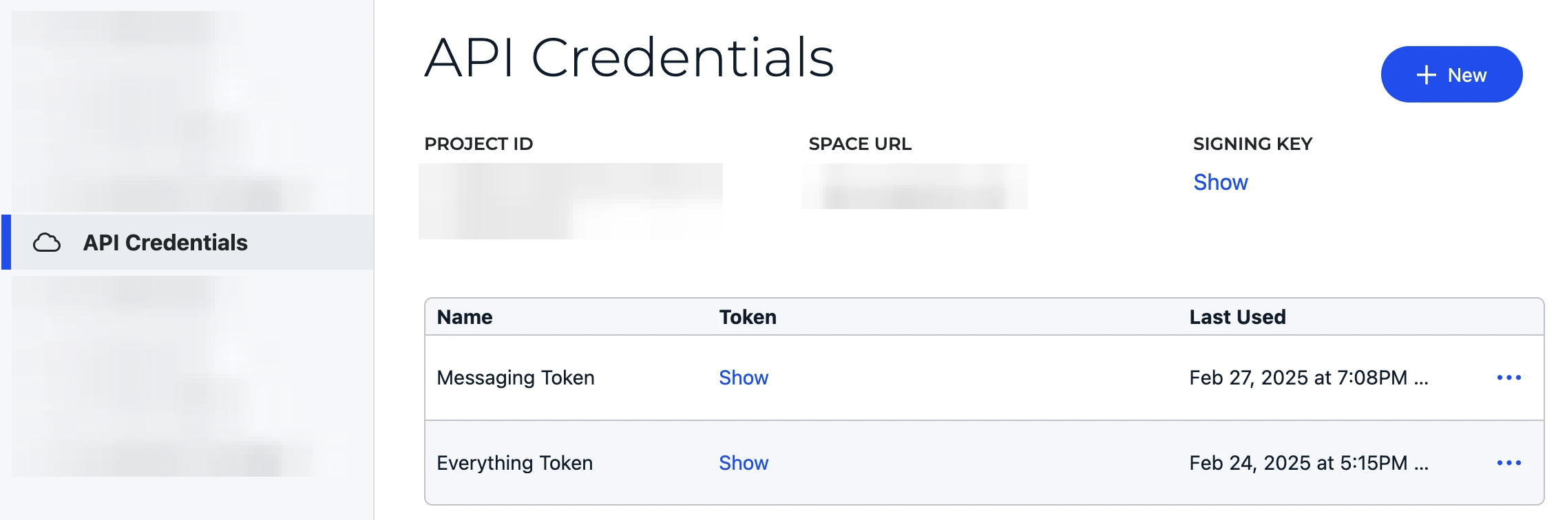

Get your signing key
Your signing key is on the API Credentials page of your Dashboard. Click Show to reveal it. Each project has its own key, so use the key belonging to the project that serves the call.
The API Credentials page in a SignalWire Space showing the signing key
The Signing Key on the API Credentials page
You can rotate the key with the reset button on the same page. A new key takes about a minute to become active, and the page shows it to you before you confirm the reset so you can copy it into your application first.
