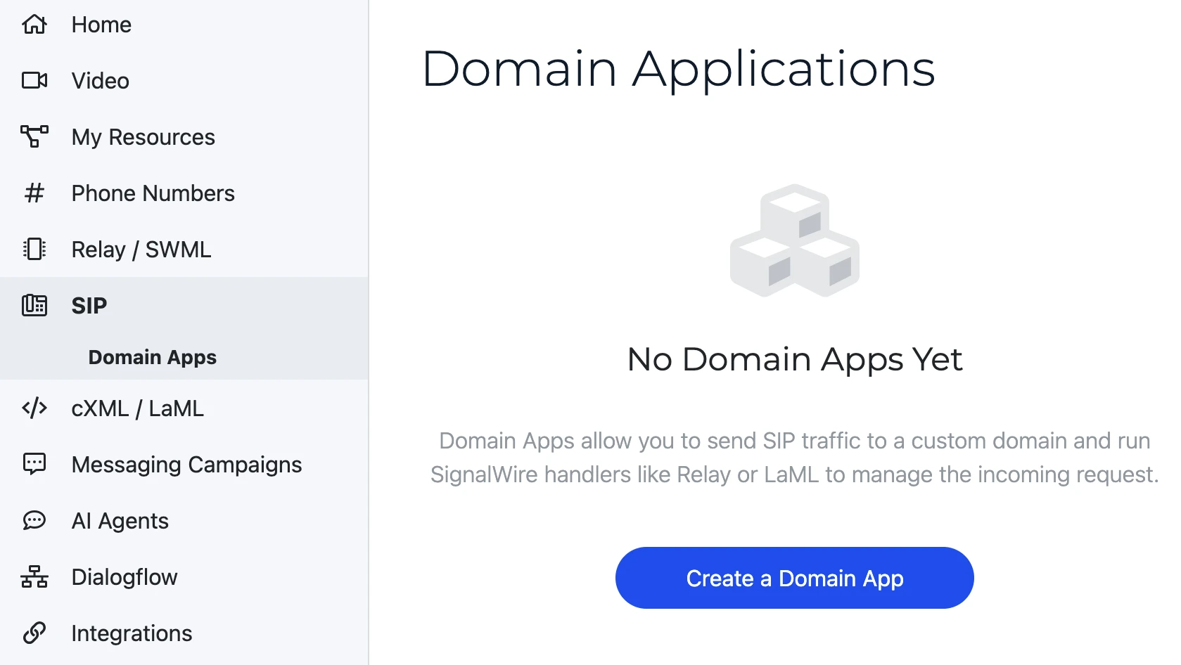

To add a SIP Address to a resource from your SignalWire Dashboard:
1
Open the resource
Open the resource you’d like to assign a SIP Address to and navigate to the Addresses & Phone Numbers tab.
Add a SIP Address
Once on that tab, click + Add, then click the SIP Address option.
Configure the address
On the New SIP Address page that appears, fill out the Domain and Display Name you prefer, then click Create.
