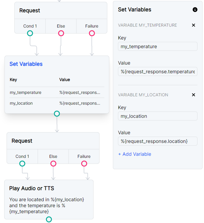

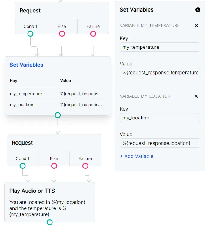

Example
Use Set Variables if you plan to use multiple Request nodes in the same Flow and you need the variables to carry across the entire Flow.
This example makes a request to an API for temperature and location. The request’s response is saved in variables called my_temperature and my_location.
In order to make a new request to a new webhook, the Set Variables node is essential because the second Request node will overwrite the request_response. Your first variables will remain accessible using %{vars.my_temperature} and %{vars.my_location}.
Set variables from a request response.
