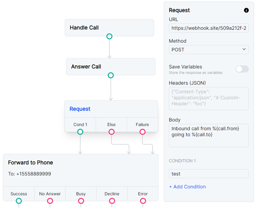

Using webhook.site to test requests
You can test the Request node with webhook.site. In the Request node, use the unique URL provided by webhook.site and copy the Body of the example below. You will get a POST to your webhook with details about the incoming call.
Request node example with webhook.site.

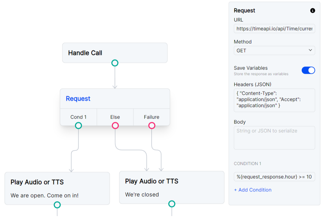

Route a call based on a request to check time
You may want your Flow to behave differently depending on the time of day. You can use timeapi.io to request the current time. This example uses an IANA timezone to look up the time and sets Cond 1 to:
%{request_response.hour} >= 10 &&%{request_response.hour} < 20.
If the time is between 10am and 8pm, the success condition TTS will play. If a condition is not met, the call will be routed to the Else connector, which will play the TTS node. If the request fails, the call will be routed to the Failure connector, which will also play the TTS node.
Request node example with timeapi.io.
