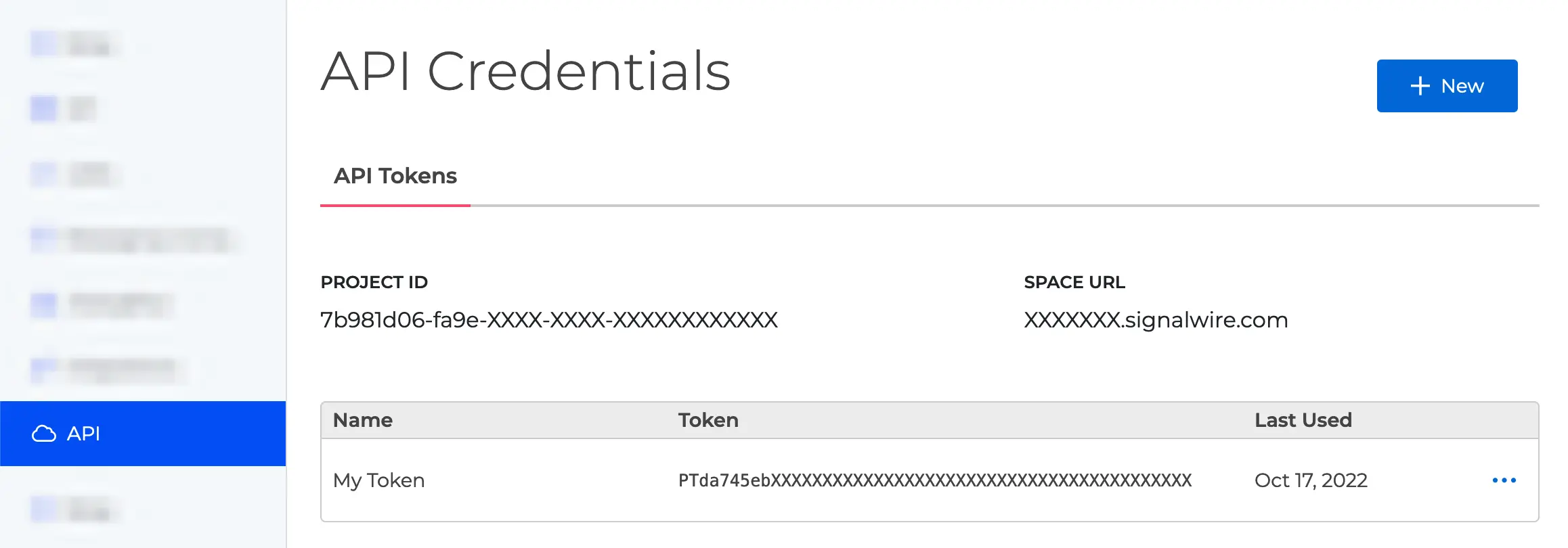

Finding your credentials
Your Project ID and API Tokens are available in the SignalWire Dashboard.
API credentials in the Dashboard.
