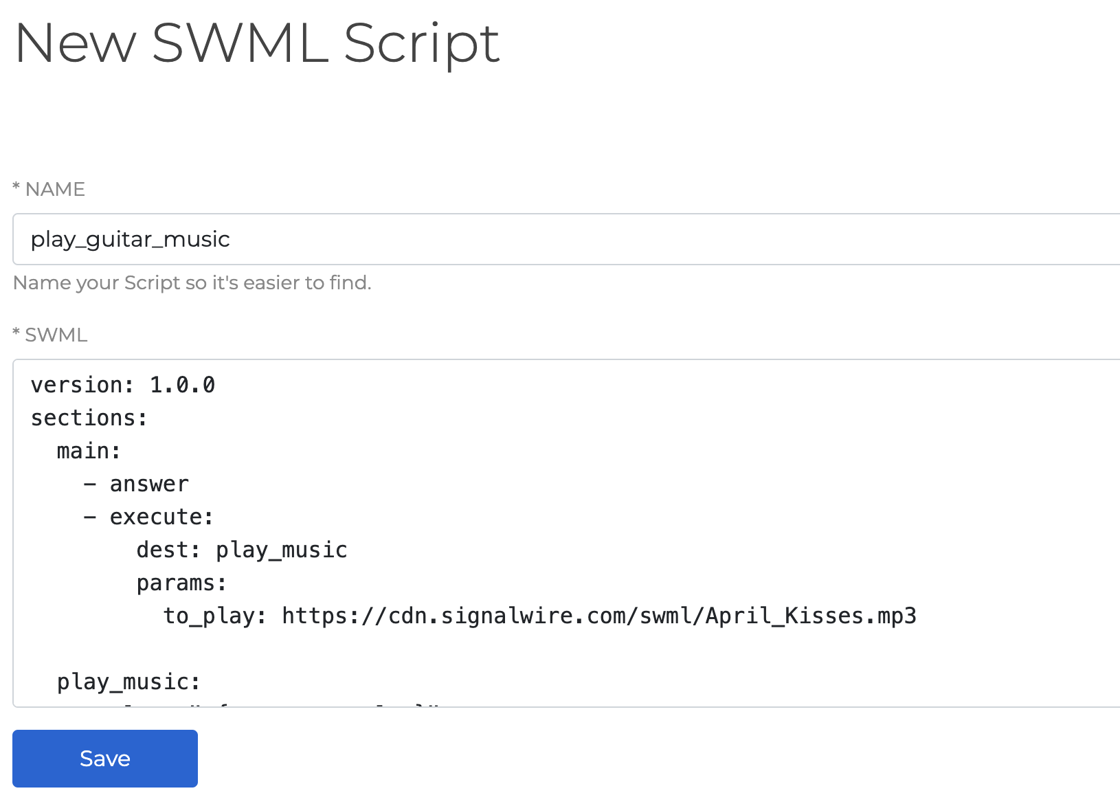

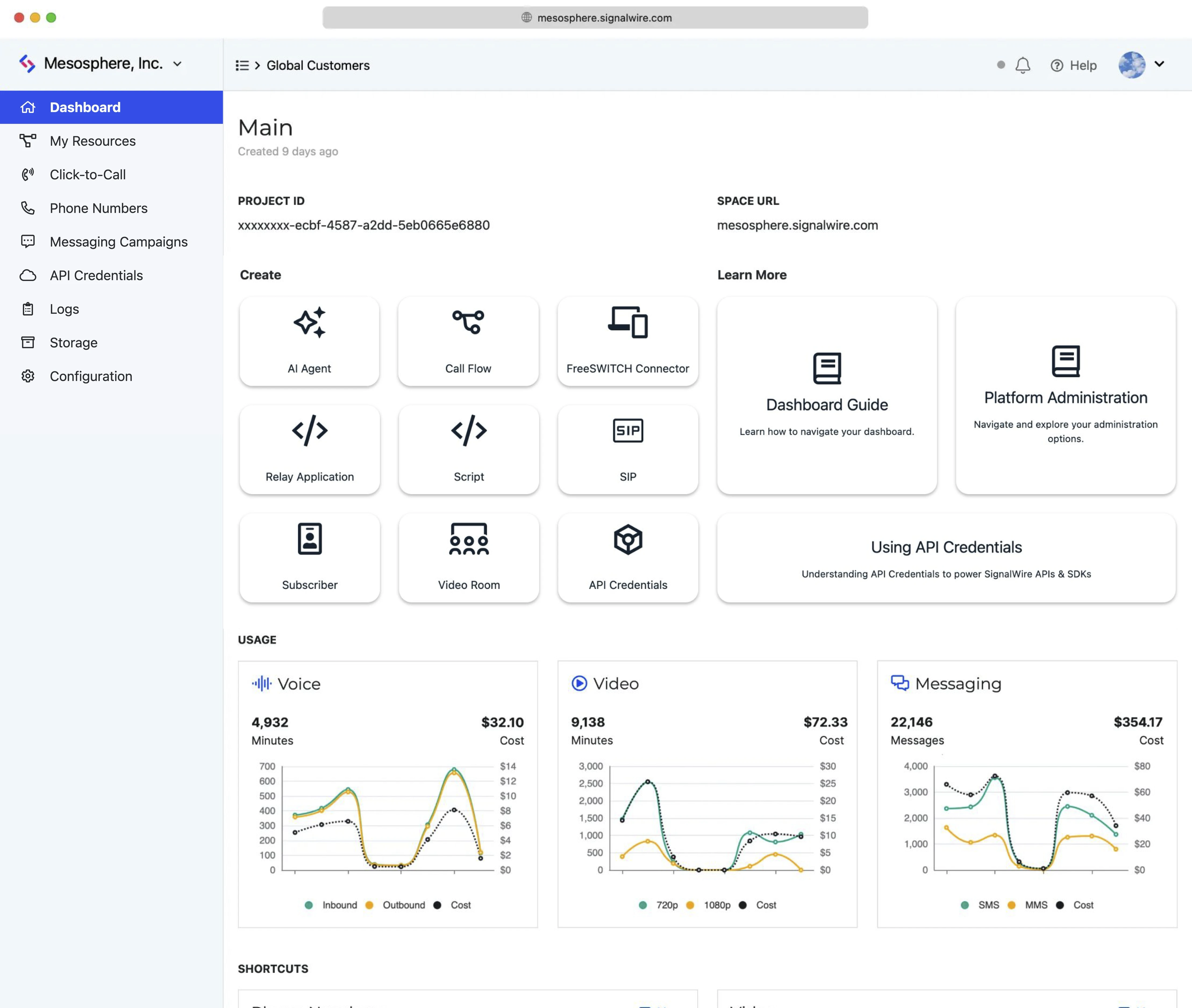

From your SignalWire Dashboard, click Script, then SWML script. This will open the New SWML Script dialog box.
Paste your SWML Script into the Primary Script field, then select Create.
If necessary, copy and paste the below example script:
version: 1.0.0
sections:
main:
- answer: {}
- play:
url: "say:Hello World!"
- play:
url: "say:Congratulations on successfully deploying your script!"
- hangup: {}
Your script will be saved in the “My Resources” section under “Scripts”.
It will remain housed here under the name you provide for easy reference.

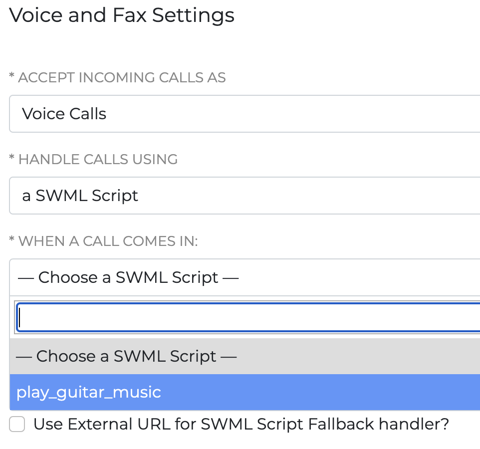

Assign a phone number
  • Navigate to Phone Numbers in your Dashboard.
  • Purchase a phone number if needed by clicking the ”+ New” button in the top right hand corner of the page.
  • Click on your phone number, then click “Edit Settings”.
  • Click on ”+ Assign Resource”, then assign your SWML Script.
Test your application
Call your assigned phone number to test your SWML application.
