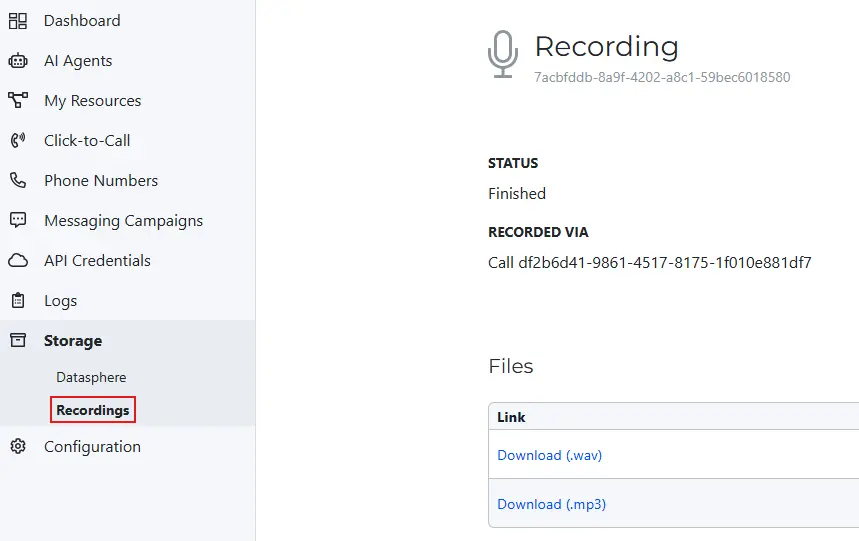

We used the record_call method to start the recording in the background, then the play method to play a text-to-speech message. The recording will be available from your SignalWire Space in the Storage section, within Recordings.
