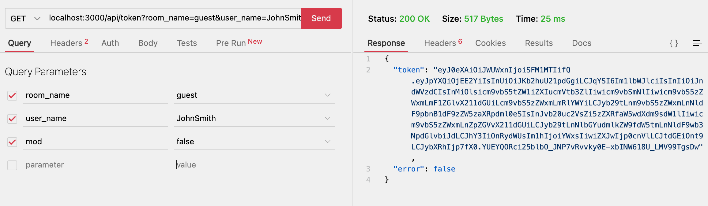

The following code will create a new endpoint at /api/token, which will query SignalWire and serve tokens given at least a valid room_name. It also takes additional user_name and mod parameters. The user_name parameter simply sets the display name for the user requesting the token. The mod parameter (short for “moderator” in this case) selects between the two sets of permissions defined in permissions.ts which can be assigned to the user.
Note that the location of this file ensures that this will run server-side at api/token endpoint. Learn more about Next.js routing here.

Thunder Client showing a GET query being used to test the /api/token endpoint.
Testing the /api/token endpoint with Thunder Client

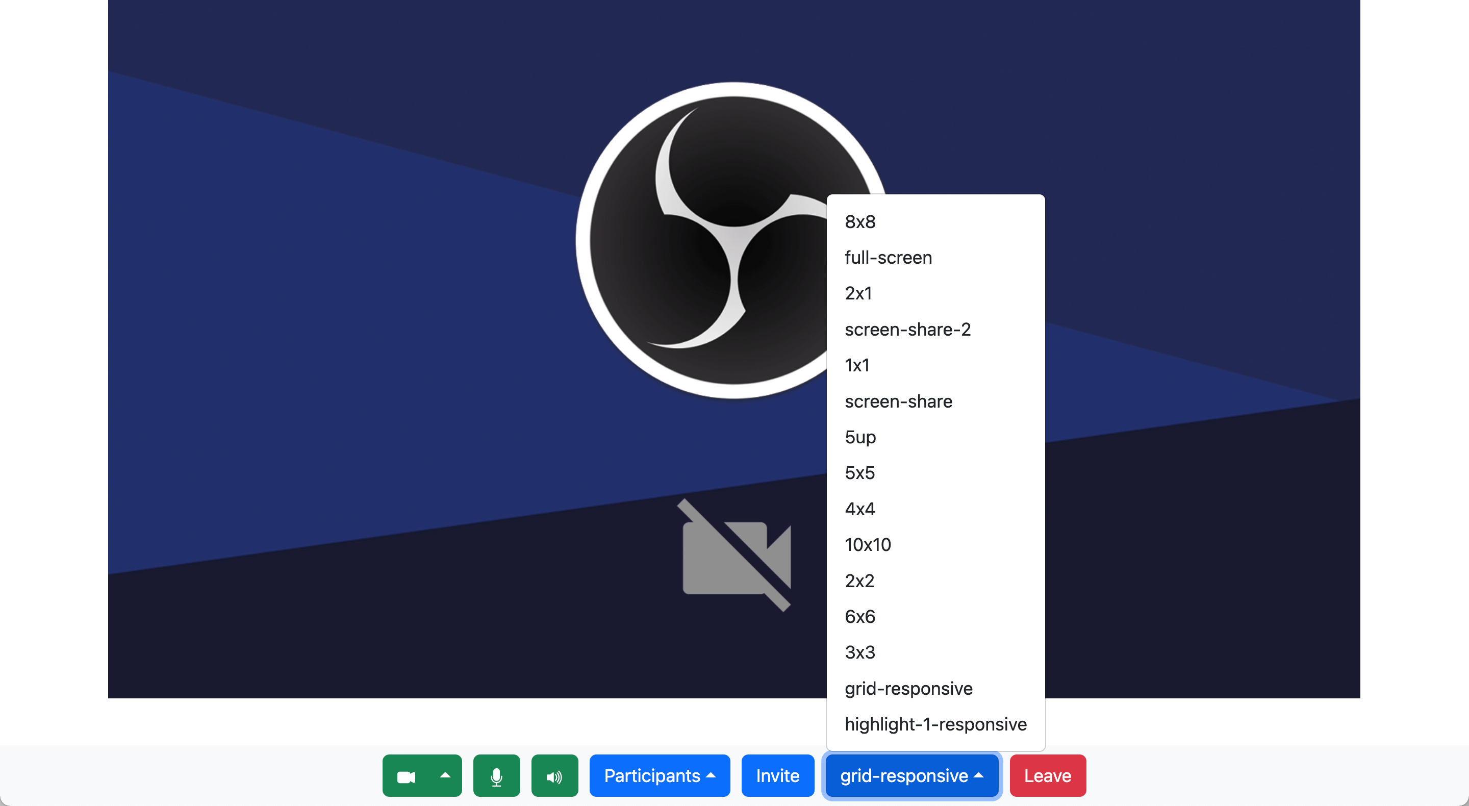

  6. The <LayoutSelector/> takes layoutControls from useLayouts hook, which has a list of all allowed layouts, a way to change layouts and the layout currently being used. It renders a selector for layouts.
a video conference, showing controls for video, audio, participants, invitations, and layout.
A video conference with all controls

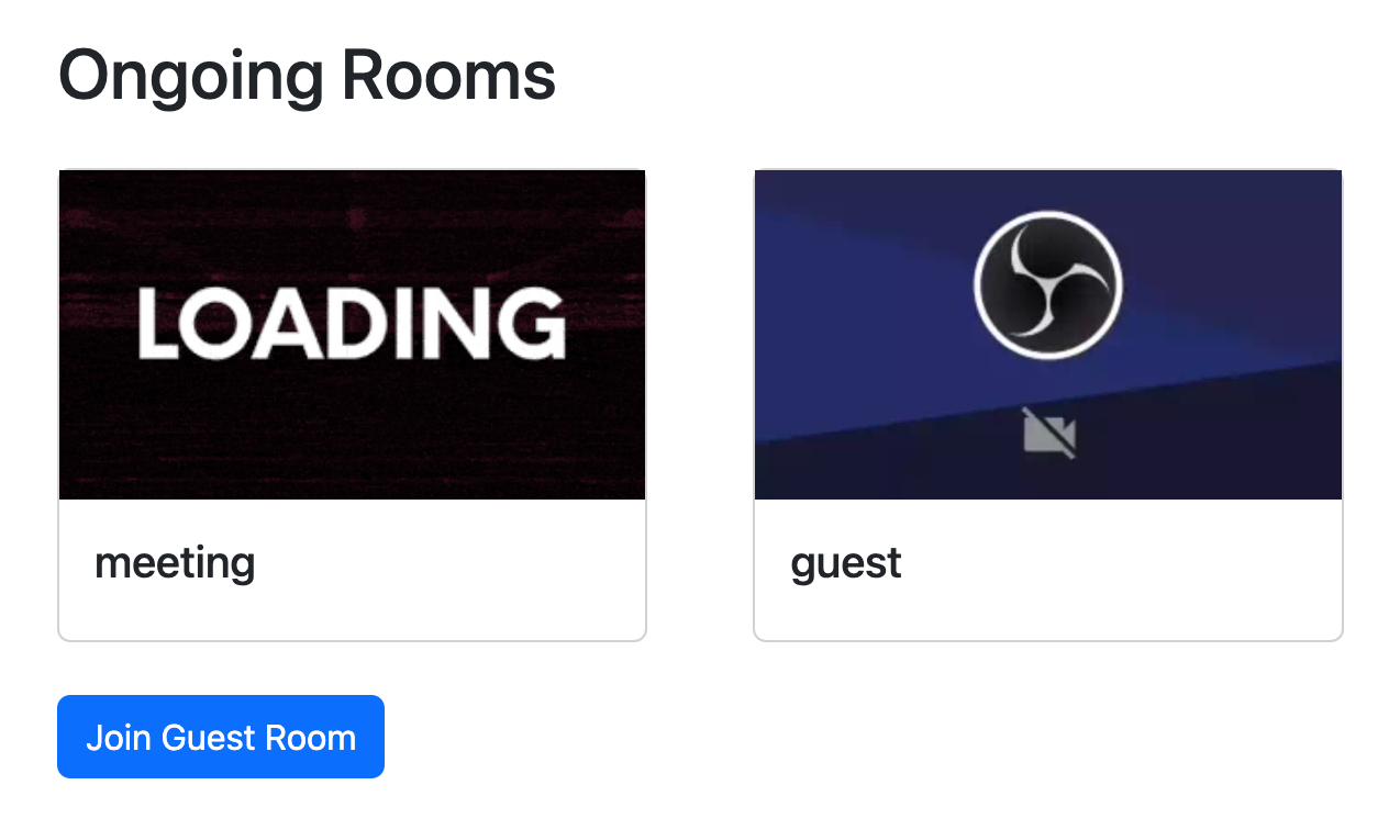

Finally, we want to display the previews of ongoing conferences in the home screen. The preview thumbnails of any active SignalWire RoomSession can be downloaded from the preview_url attribute of the session.

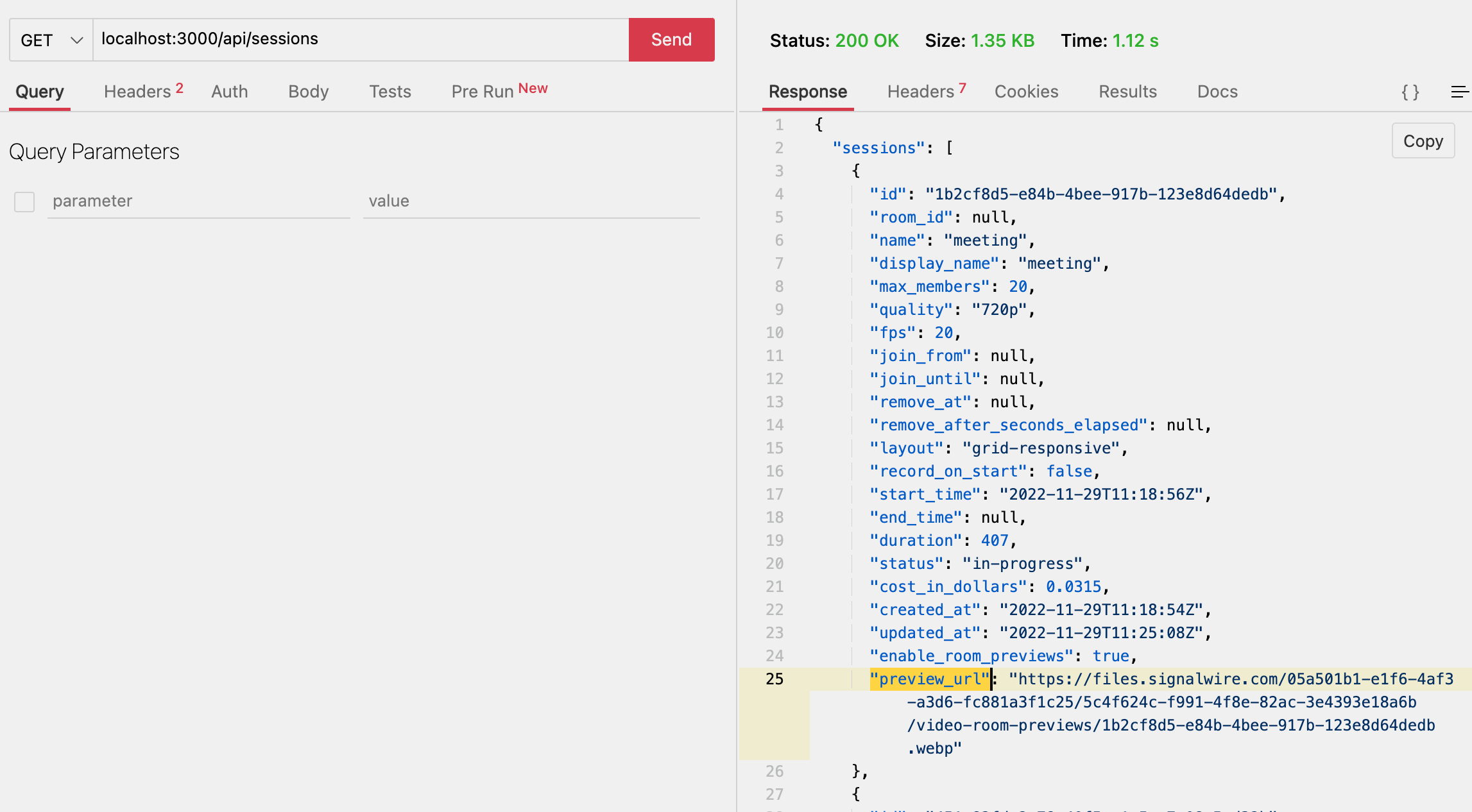

We can query for the list of active room sessions via the REST API at the room_sessions endpoint. Sending a GET request to this endpoint with a query parameter status set to in-progress will get us the list of active room sessions.
Again, since this is a REST API call, this will have to be done in the server and proxied to the client.

a GET query in Thunder Client. A GET request is being sent to /api/sessions.
Sending GET request to '/api/sessions'
Now we have created an endpoint at /api/sessions which, when called, sends a GET request to the room_sessions endpoint with the authentication information, and passes that information to the client.

two thumbnail images representing ongoing rooms, with the option to join.
Thumbnails of ongoing room sessions being displayed.
