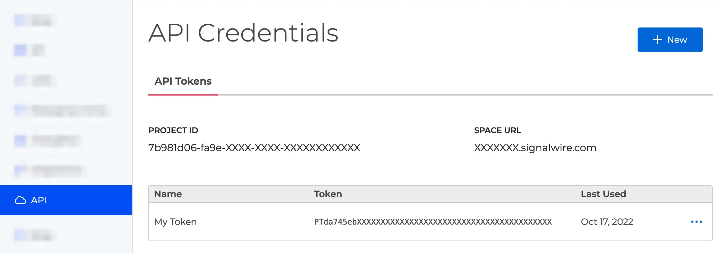

Obtaining your SignalWire API Token
First, we need to obtain some authentication information from SignalWire. Login to your Space here, and from the left menu go to the “API” page. Once you have navigated to the API page, click on “Create Token”. Give it a name so that you can identify it later, and make sure that the “Video” scope is enabled. Then hit “Save”. After the token is created, you will see it listed in the table.
Here are the three pieces of information that you need to copy:
  • Project ID
  • Space URL
  • Token
The API page shows the active Project ID and Space URL, and a list of API tokens organized by Name, Token, and Last Used.
You need to put these values in the .env file inside the backend folder:
PROJECT_ID=...
API_KEY=...
SPACE=...
We are now ready to make requests to the SignalWire REST APIs.
