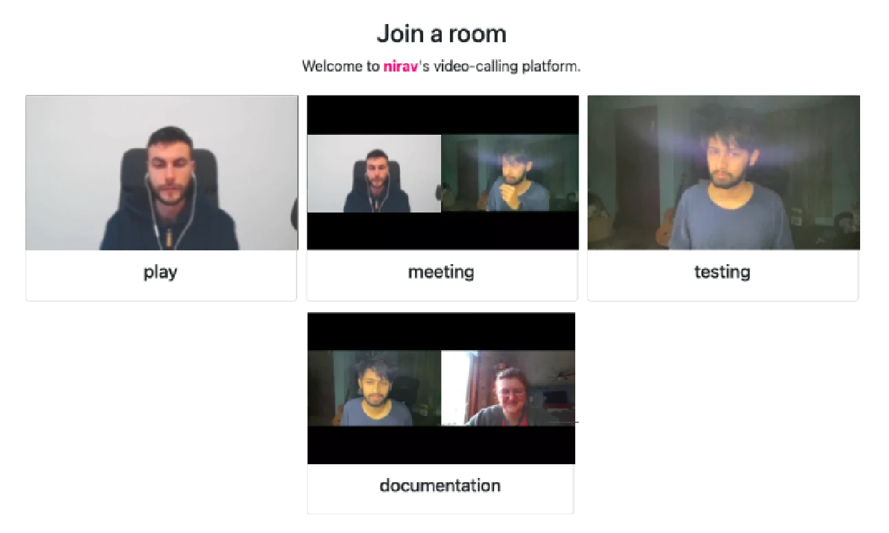

Once you start to host multiple rooms with several people each, you might want a way to peek into the rooms. Room names only take you so far.
A preview of a Video Room. Text at the top reads 'Join a room'. Four previews are shown, each labeled with the room name.
Room Previews
Introducing Video Previews
Video previews are live thumbnails of the ongoing room sessions. They refresh twice every minute, and record a small slice of the room. You can use these previews to represent a room.

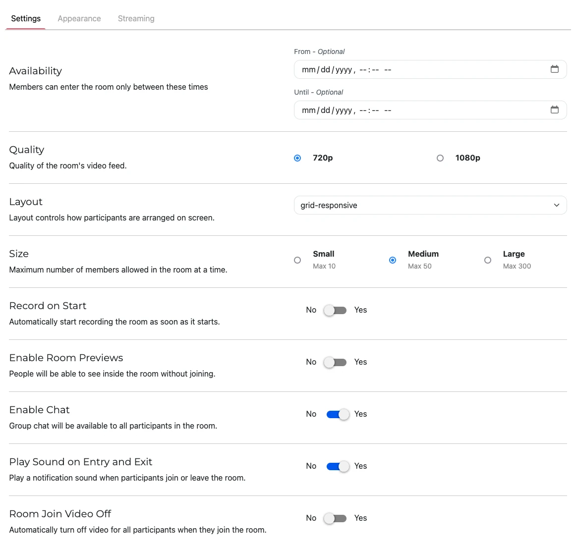

If you’re using the new programmable video communication tool, just turn on Enable Room Previews option from settings.
This screenshot shows the configuration options for Video Conferences.
Turning room previews on from the UI.
