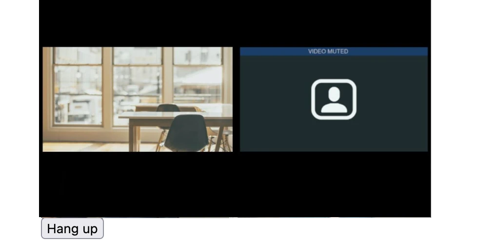

When the site is finished, it will look something like this:
a video call with two participants and a button labeled 'Hang up' beneath the video.
The end result of this tutorial.

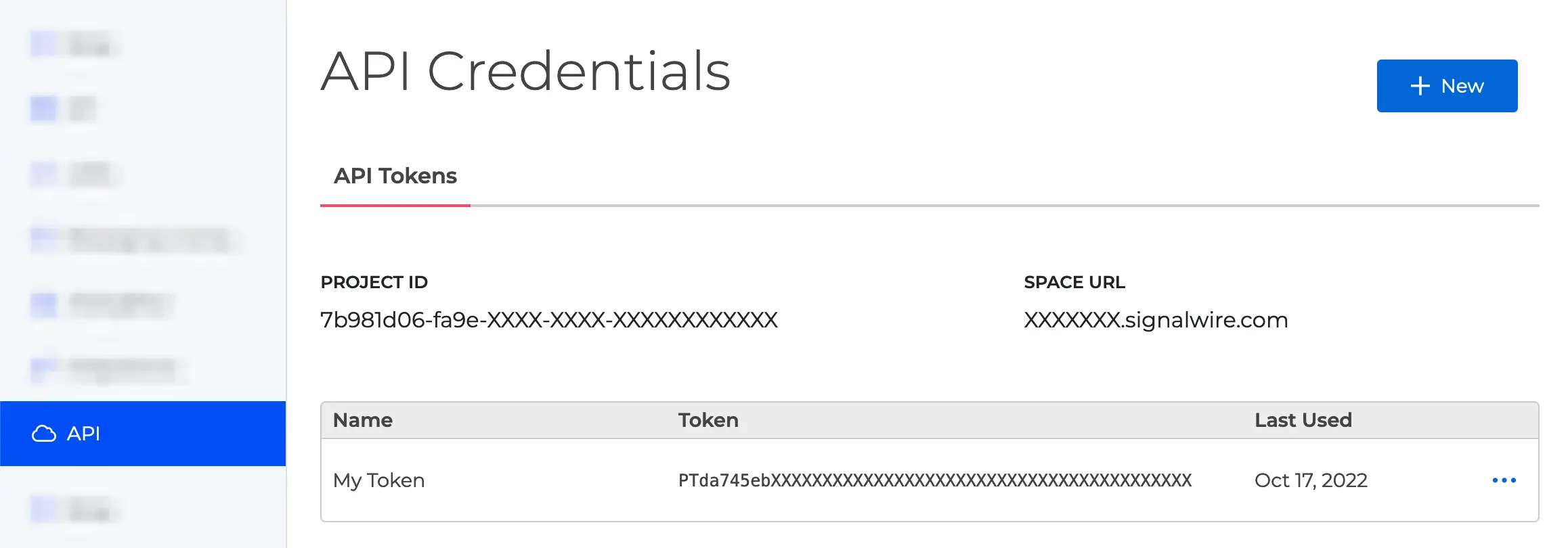

First, we will need access to the SignalWire APIs. If you already have a SignalWire account, can sign in to the SignalWire website. If you’re not already registered, you can sign up in trial mode, which comes with a $5 credit. This will be plenty to follow along with this guide.
Once you’ve signed up and verified your email, create a new project. Next, navigate to the API Credentials page page of your SignalWire Dashboard.
The API page shows the active Project ID and Space URL, and a list of API tokens organized by Name, Token, and Last Used.
Two important pieces of information about our project are displayed there:
  • Space URL: You’ll use this URL to access SignalWire APIs
  • Project ID: You’ll use this UUID to specify your project to the API
There is one more piece of information that we need from our new project. We need to generate an API token to access SignalWire’s APIs from our own code.
To generate an API token, click on the New Token button. Give it an easily identifiable name, and make sure that the “Video” scope is enabled. Then hit “Save”.
It is important that the API tokens are not publically exposed. They can be used to make API requests on your behalf. Take extreme care to make sure that the tokens are not pushed to GitHub or exposed in frontend code. For Node.js backends, you can use dotenv files or similar mechanisms to safely store confidential constants.
Now that we have collected the Project ID, the Space URL, and the API token, we can start writing our application.

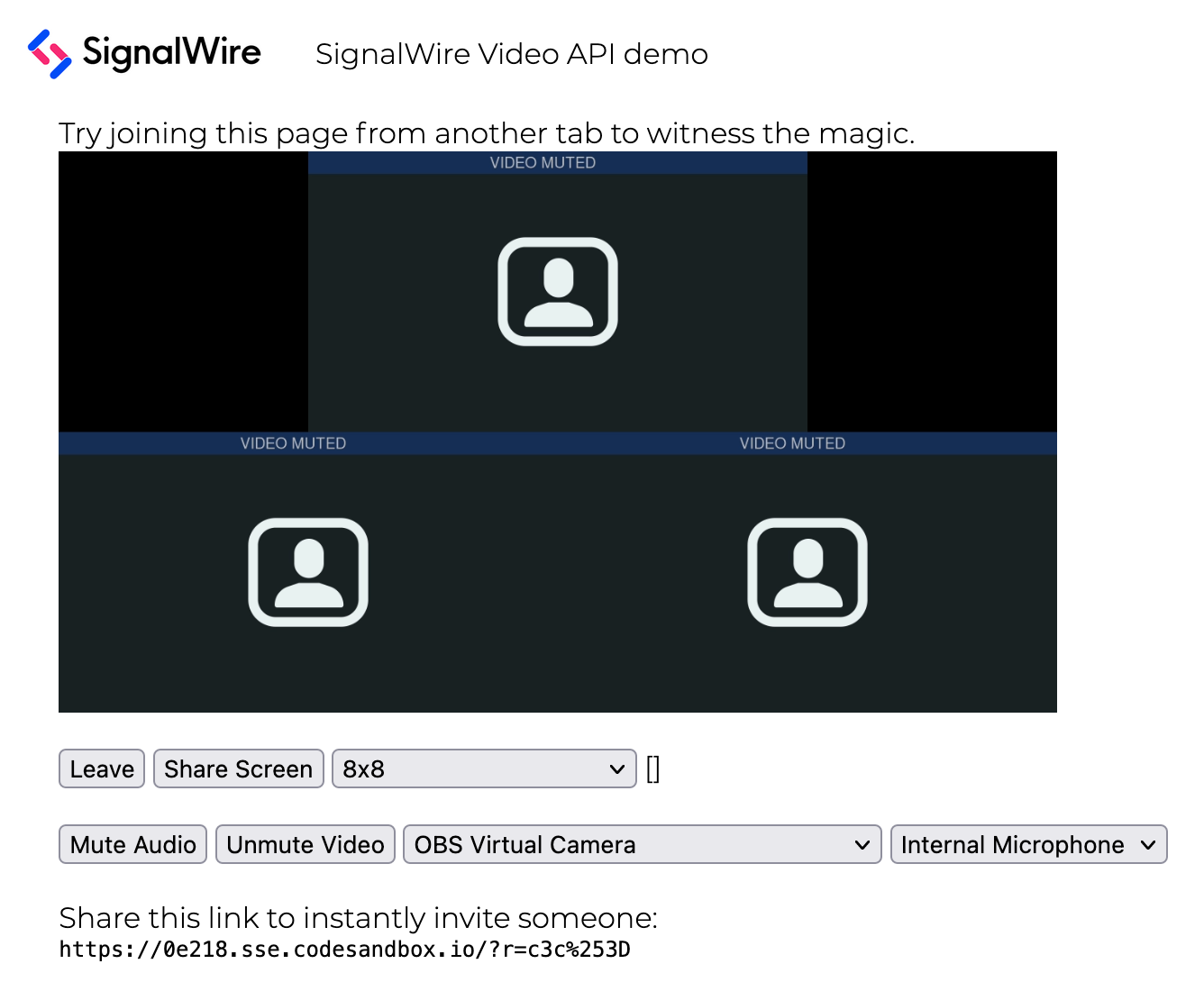

Here is the final result of our development with a preview of some added features:
SignalWire video call with controls for screen share, layout, audio, and video.
The most noteworthy thing about SignalWire Video technology is that it only streams a single video stream no matter how many participants there are. The video is composited on powerful SignalWire servers by stitching all of the individual video streams together. So you can invite as many people as you like to your virtual video party. Your app will run without a hitch.
