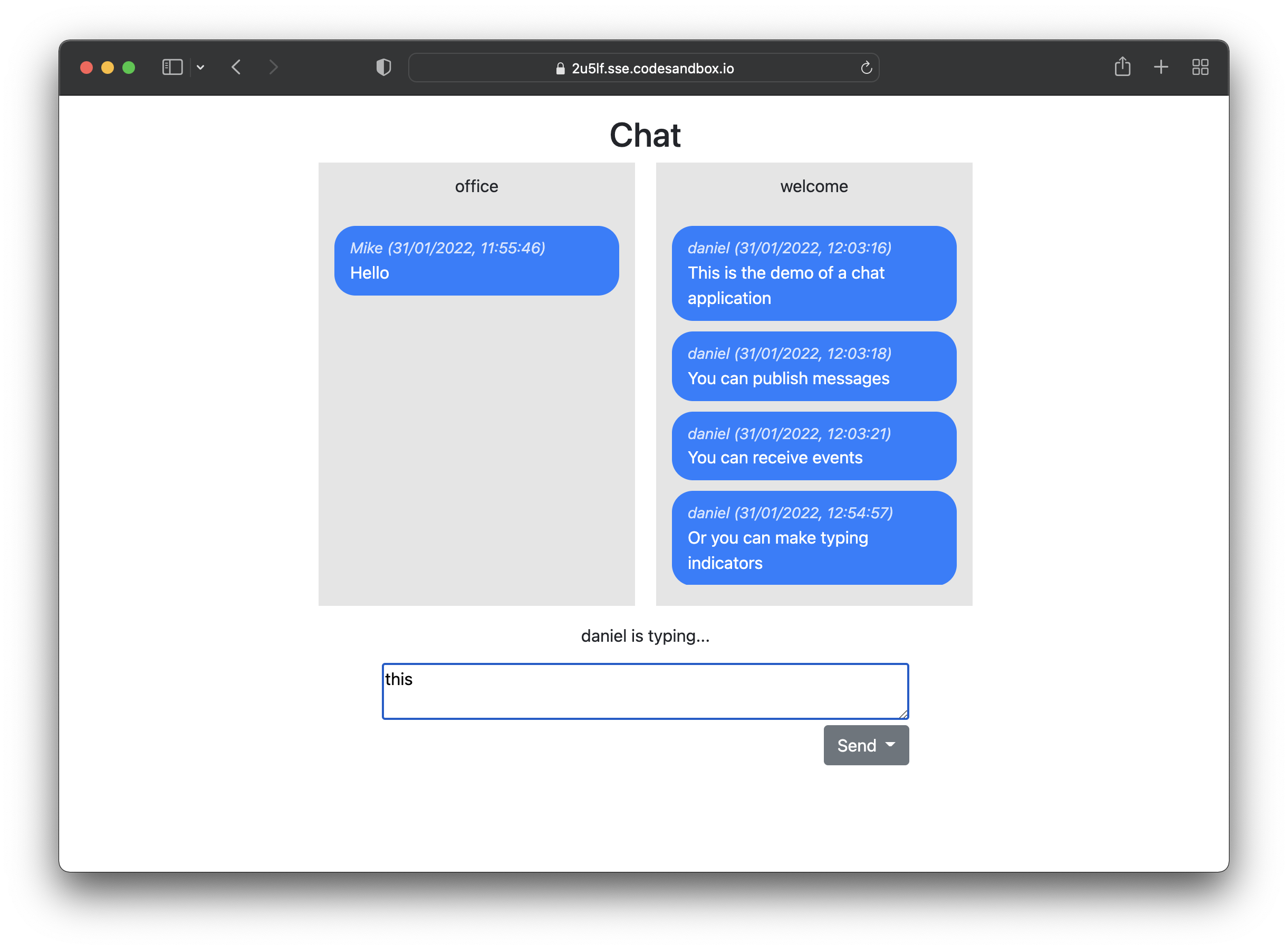

In this guide we will explore a simple chat application built using the SignalWire SDK.
Chat application demo screenshot showing multiple users and messages
The chat application you will build.
