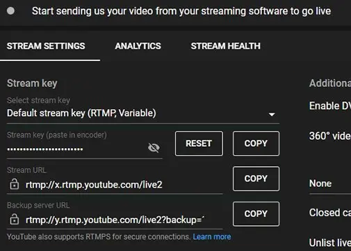

You also need to set up your streaming service. Any service supporting RTMP or RTMPS works with SignalWire. In any case, you will need a stream URL and, sometimes, a stream key. For YouTube, you will find your stream key and your stream URL in a screen such as the one depicted in the image below.
The YouTube stream parameters menu. The Stream Settings tab is selected, with fields for Stream Key type, Stream Key, Stream URL, and Backup server URL. Appropriate SignalWire parameters have been entered in each field.
YouTube stream parameters. Regardless of the streaming service that you are using, you need to make a note of the stream URL (which usually starts with 'rtmp') and, when provided, of the stream key.
