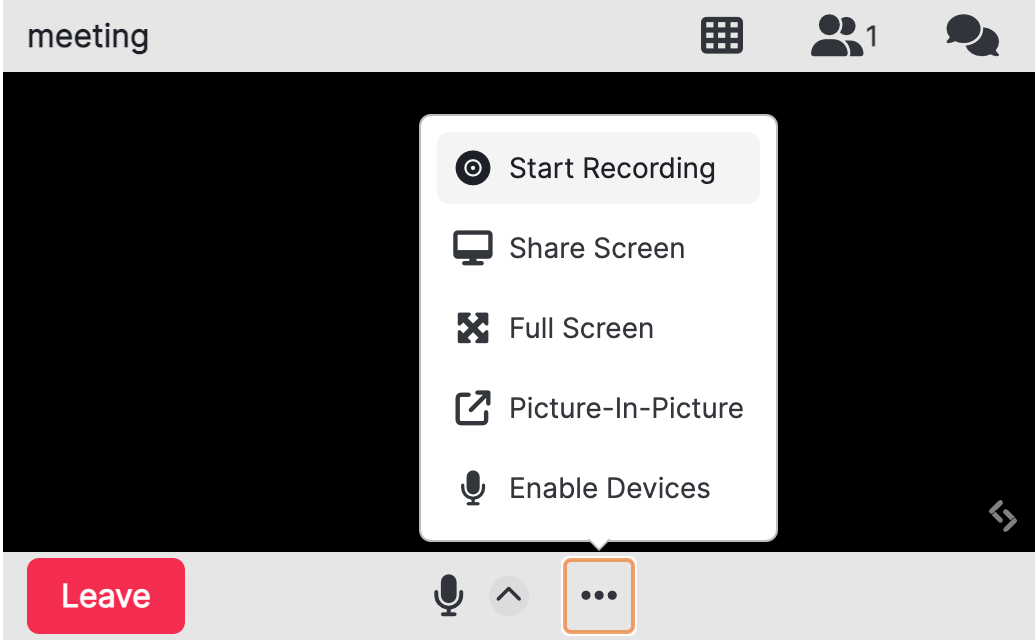

If you are using Embeddable Video Rooms in your website, just click the Start Recording option to start the recording.
Anyone with a moderator token will be able to start and stop recording. Embed the guest video room version on public pages for people that shouldn’t be able to control recordings.
Embedded video conference widget with Start Recording' selected
Starting a recording from the Embeddable Video Conference Widget.
