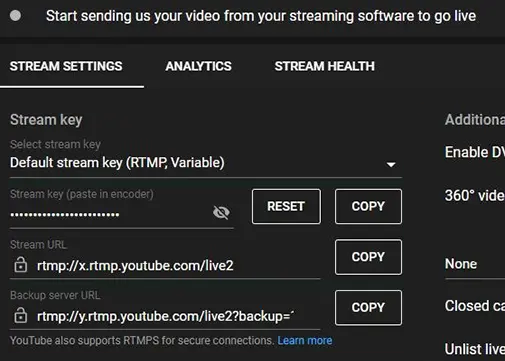

You also need to set up your streaming service. Any service supporting RTMP or RTMPS works with SignalWire. In any case, you will need a stream URL and, sometimes, a stream key. For YouTube, you will find your stream key and your stream URL in a screen such as the one depicted in the image below.
