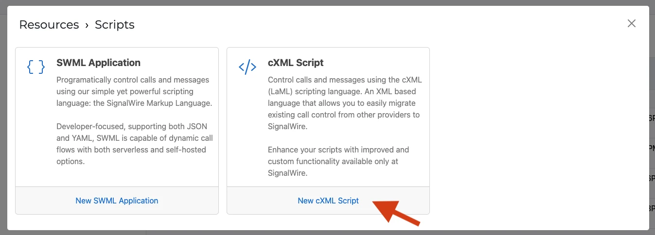

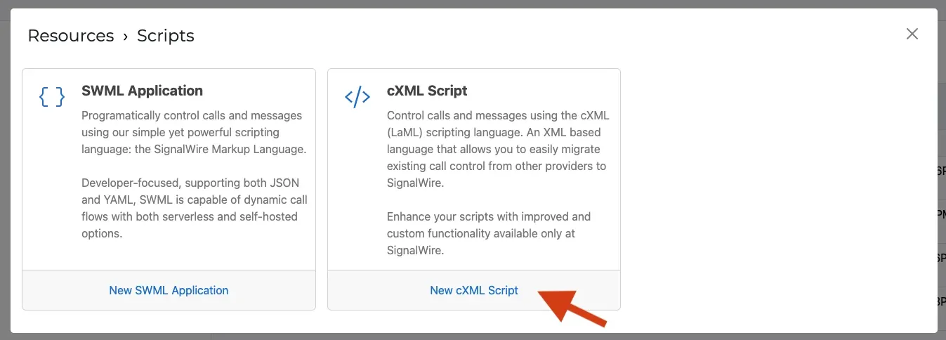

Create a cXML Script
Navigate to the “Resources” tab from the sidebar and create a new Resource. There, select the resource type of “Script”, and pick “cXML script”.
Create a new cXML script.

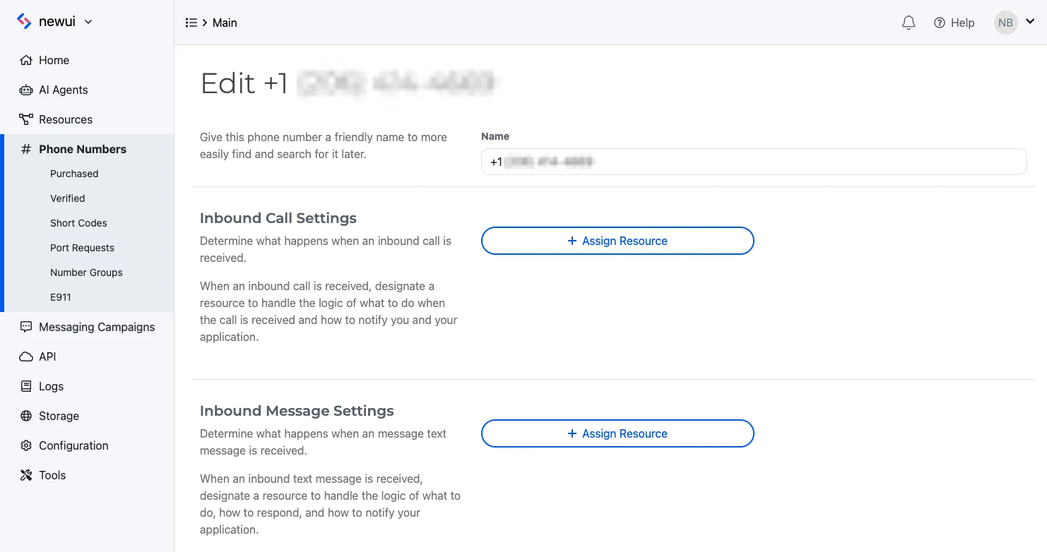

Navigate to the “Phone Numbers” section of your Dashboard and open the settings for the number you want to configure. There, assign the cXML script you just created to handle messages.
Open the settings for the number.
