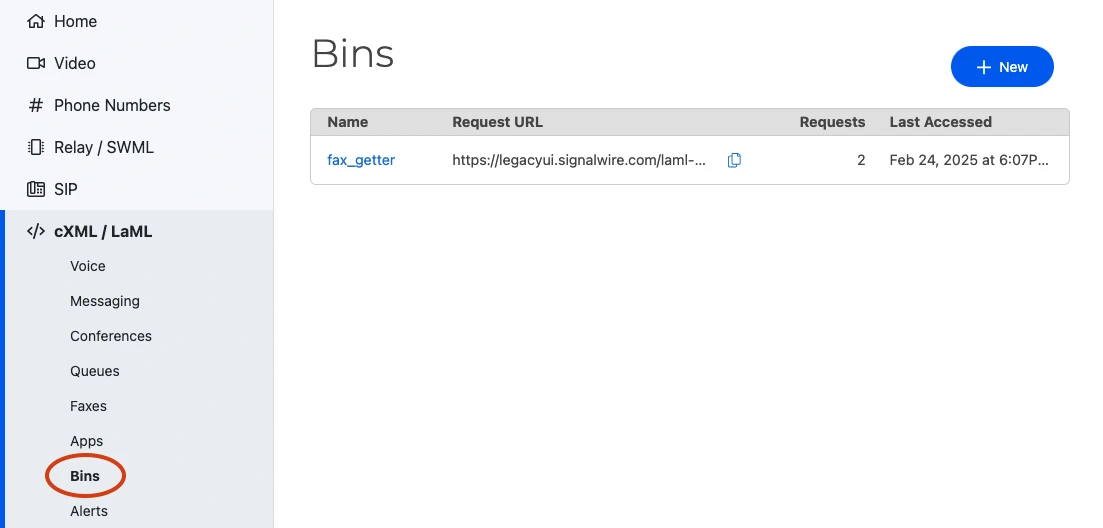

To create a cXML Script, select My Resources in the left sidebar of your SignalWire Dashboard, select + Add, choose Script, and then choose cXML Script.
Paste the following XML content in your new cXML Script, replacing the action URL with the URL of your server. The below code is taken from the Receive a Fax in Compatibility XML example.
