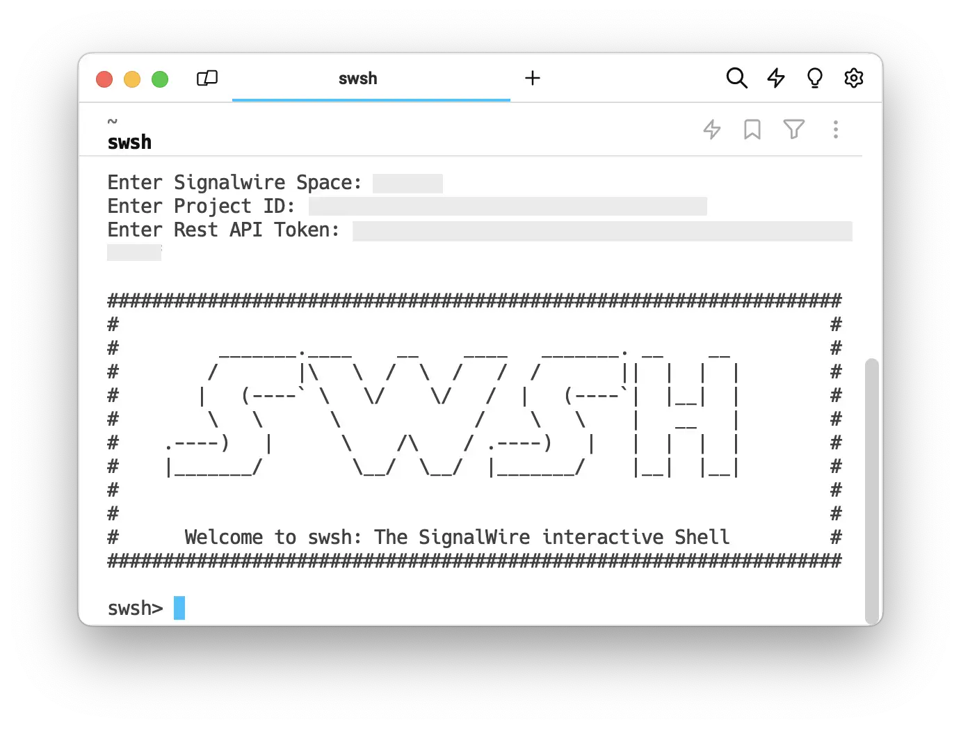

The SWSH command prompt.

Now that SWSH is installed, you can start a shell with it by running:
swsh
