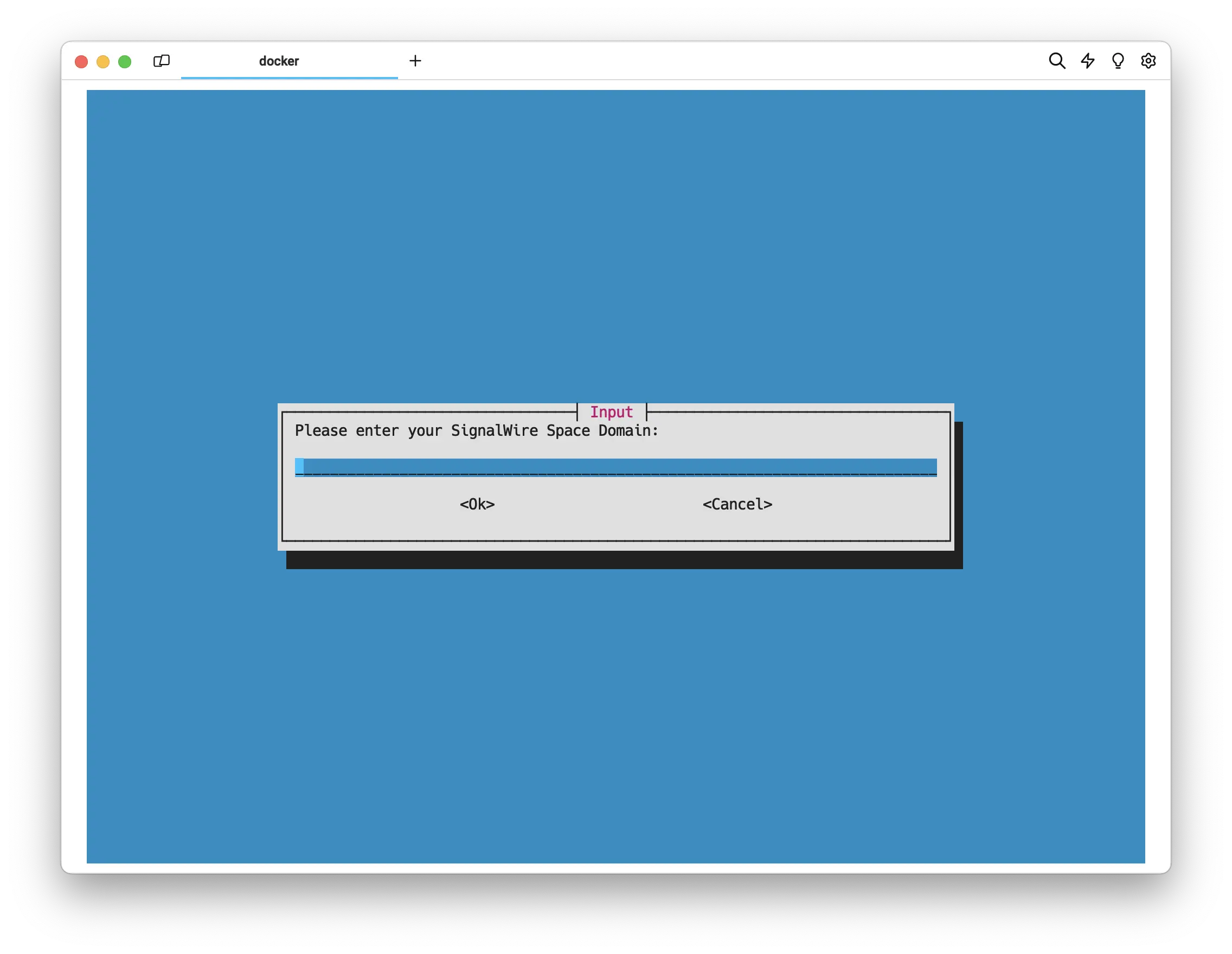

Follow the prompts on screen to enter your SignalWire Space, Project ID, and API token. Your SignalWire Space is the subdomain that prefixes .signalwire.com. In other words, if your Dashboard is accessed at https://spacename.signalwire.com/dashboard, you should enter spacename when prompted for your Space. Copy the Project ID and REST API token from the API pane of your SignalWire Dashboard.
$docker exec -ti wirestarter bash
The WireStarter interface. The user is prompted to enter their SignalWire Space domain.
When prompted, select your preferred editor: nano, vim, or emacs. We recommend nano for beginners.
Copy the SignalWire Space ID, Project ID, and Project token from the API pane of your SignalWire Dashboard. Copy the ngrok Token from the Your Authtoken ngrok page. ngrok Args are optional and only needed if you want to use a custom ngrok domain name. If not, leave the text field blank and proceed.

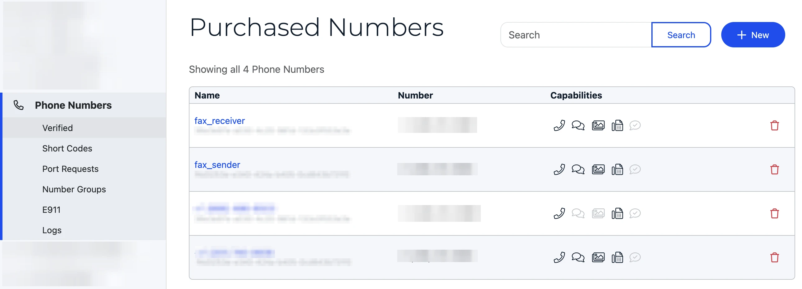

Phone numbers purchased in the Dashboard UI must be named before being assigned to these demos. Any name will work — just edit and save the populated number as its own name. Numbers purchased in SWSH are not affected by this limitation.

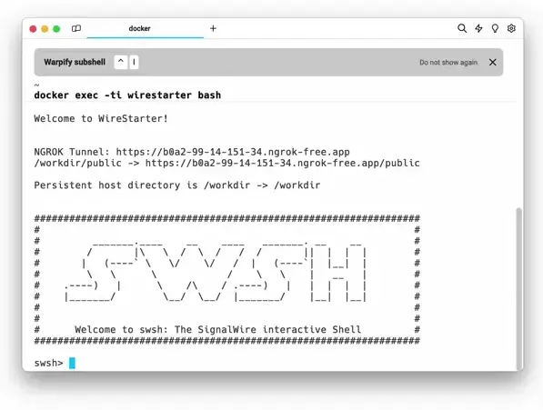

The SWSH terminal.
Purchase and configure a phone number using the phone_number command.
Enter help or help -v to view more options for SWSH.
You can also purchase a phone number in the Web UI in your SignalWire Space.
Purchased phone numbers
