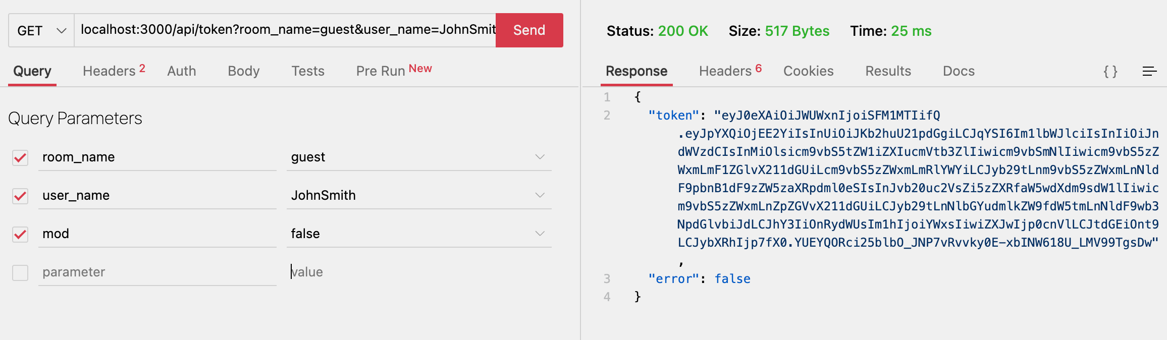

Thunder Client showing a GET query being used to test the /api/token endpoint.
Testing the /api/token endpoint with Thunder Client
This simple backend will suffice to be able to conduct video conferences. But we will have one more endpoint to add here to support room previews.

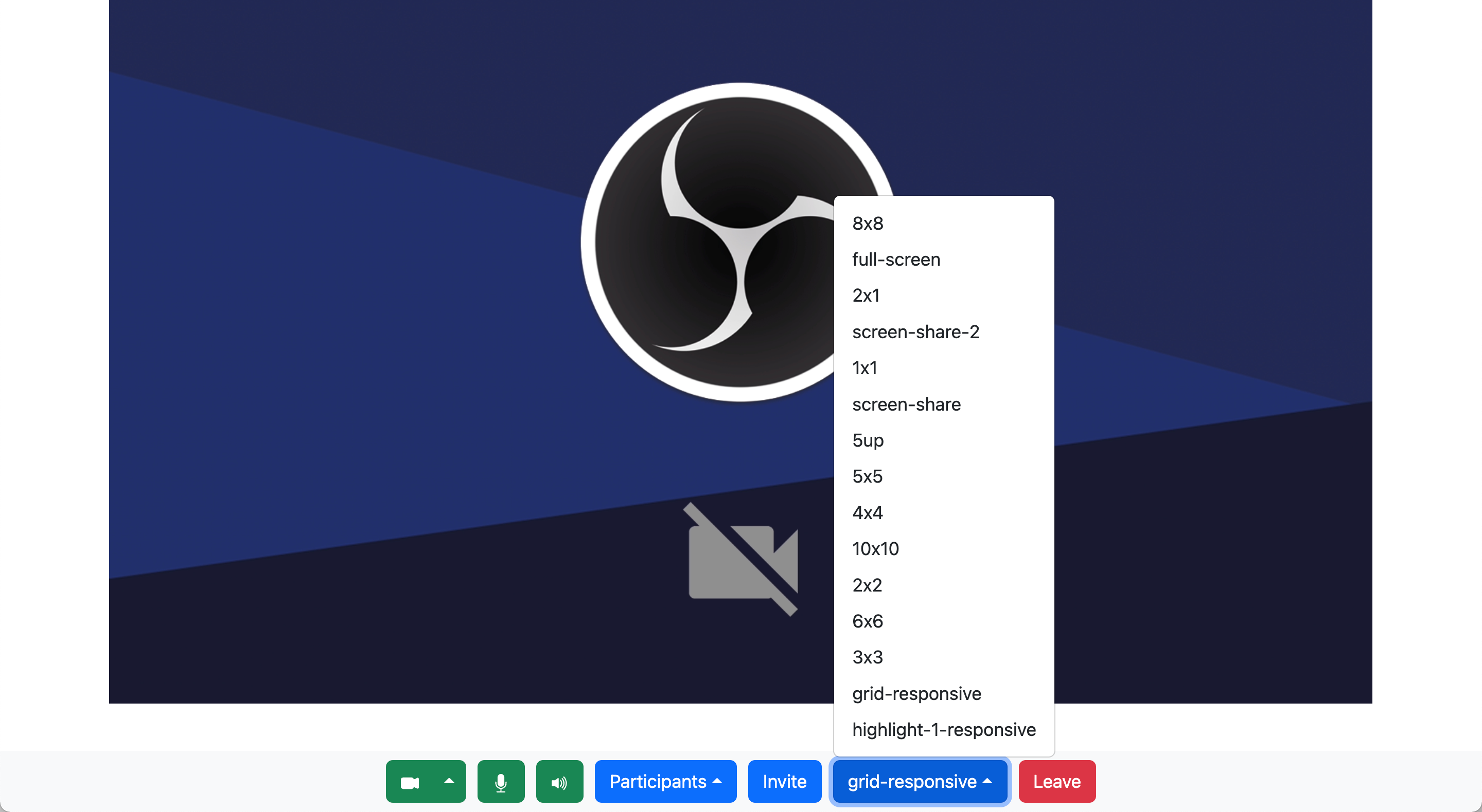

There are some interesting things going on in this code.
  1. The component <Toolbar/> takes only a RoomSession object as prop, because we only need that object to manipulate the room.
  2. The usePermissions() hook is being used to check for permissions allowed to the user and only render the controls which are allowed. The usePermissions hook maps the permissions given to the user (like room.member.video_mute) to an object P?.member?.video_mute). It also adds some convenience aggregates. For example, P?.layout is true if both room.list_available_layouts and room.set_layout is true. Similarly, P?.member?.video_full is true if both mute and unmute permissions are given to the user.
  3. We are passing a disabled prop to all controls. It doesn’t make sense to have the buttons look active when the room is not connected. So we use the useStatus hook is used to check if the room is active, and only enable the controls if it is.
  4. To the <Participants/> component, we are passing the member array from useMembers. The component simply renders the list of members with a .map().
  5. To the <Controls/> component, we are passing the self object, which is a reference to the current user. It renders the mute/unmute buttons for microphone, camera, and speakers. It also allows users to change devices being used (switch from one webcam to another or from earphones to speakers) using another hook useWebRTC, which we will discuss further below.
  6. The <LayoutSelector/> takes layoutControls from useLayouts hook, which has a list of all allowed layouts, a way to change layouts and the layout currently being used. It renders a selector for layouts.
a video conference, showing controls for video, audio, participants, invitations, and layout.
A video conference with all controls

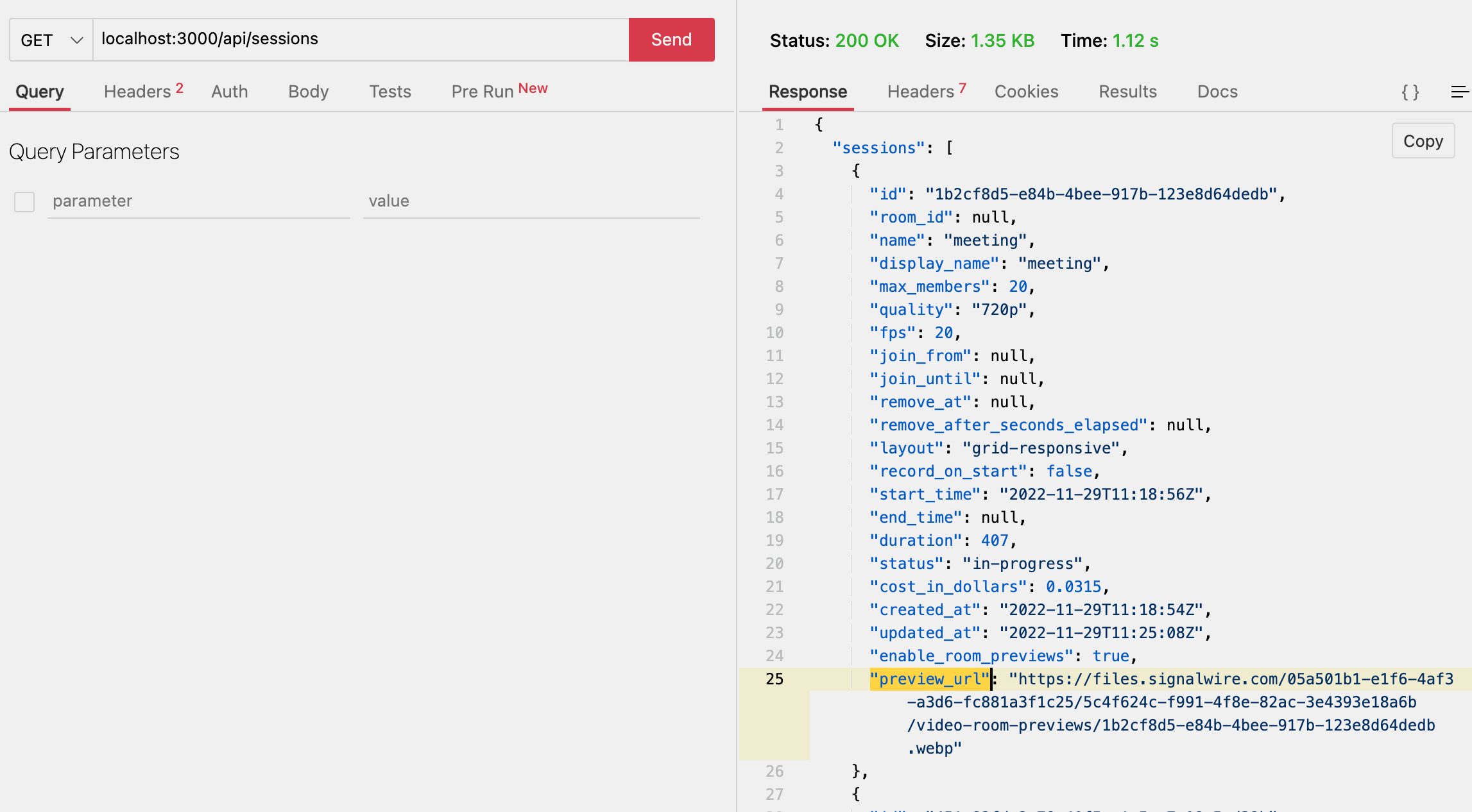

a GET query in Thunder Client. A GET request is being sent to /api/sessions.
Sending GET request to '/api/sessions'
Now we have created an endpoint at /api/sessions which, when called, sends a GET request to the room_sessions endpoint with the authentication information, and passes that information to the client.

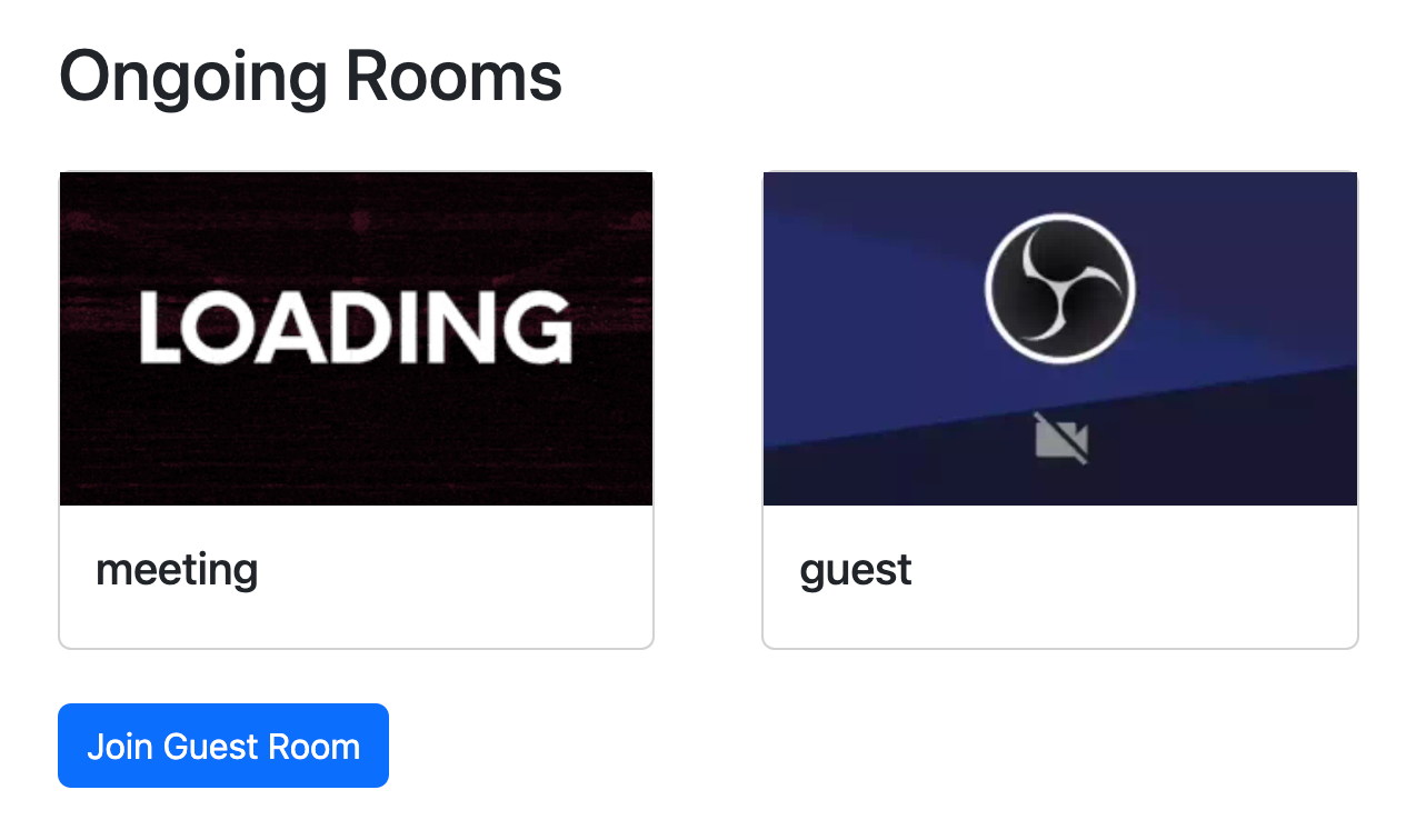

With that bit of backend in place, creating a frontend should be very simple. @signalwire-community/react already comes with a <RoomPreview/> component (described in detail here).

two thumbnail images representing ongoing rooms, with the option to join.
Thumbnails of ongoing room sessions being displayed.
Again, we are using the useSWR hook to fetch data from the server, but any way you use to GET /api/sessions should be fine. With useSWR however, the data is automatically cached and refreshed after changing tabs or network loss.
