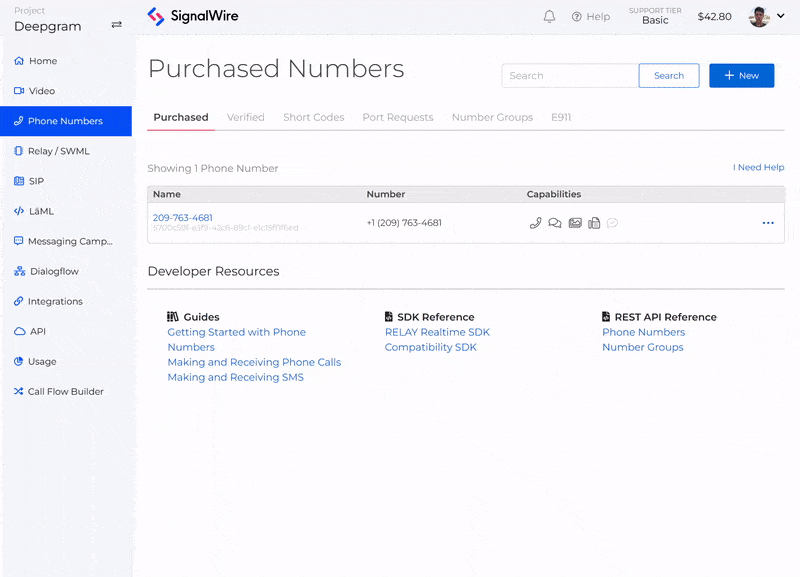

For simplicity, we’ll connect a phone number to this endpoint by changing its settings, so when a phone call comes in SignalWire asks startStreaming for what to do next:
