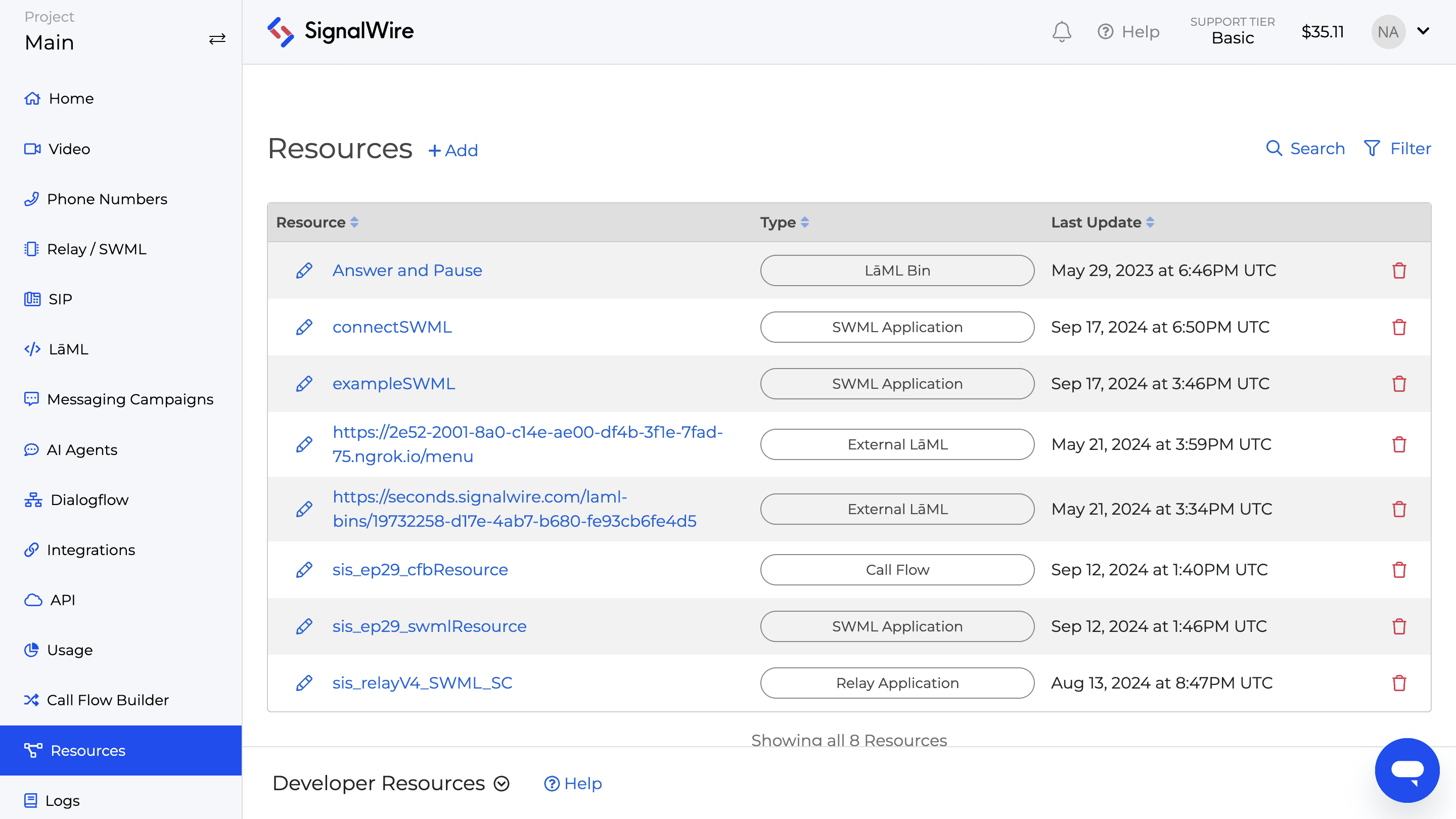

Within Call Fabric, resources represent primitives, including tools like Video Rooms, RELAY Applications, or AI Agents—just to name a few.
Creating Resources
From the home screen of your SignalWire Space, navigate to the Resources tab on the left-hand sidebar. If you’ve used SignalWire before, you should be greeted with a list of pre-configured resources from assets that you’ve previously developed.
The simplest way to create a new Resource is to click on the + Add button.
Editing Resources
To edit a saved resource, click on the pencil icon beside your desired selection’s name in the overview page. Alternatively, you can use the search function to find the resource and navigate from there. When you are ready to commit your changes, click the Deploy button.

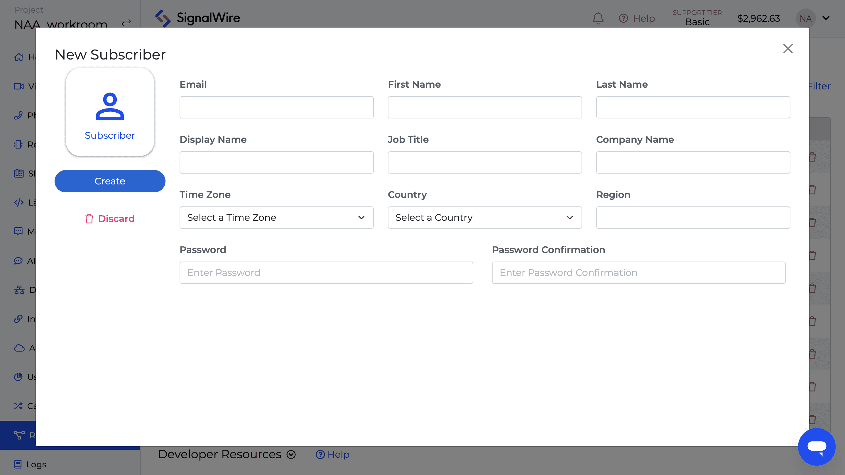

Subscribers
Subscribers are perhaps the most notable paradigm shift within the SignalWire platform. They represent authorized end users—such as call center agents—that can be provisioned with the means to initiate outbound calls, enter a chat room as an administrator, and more.
Keep an eye out for further information about Subscribers in the future.

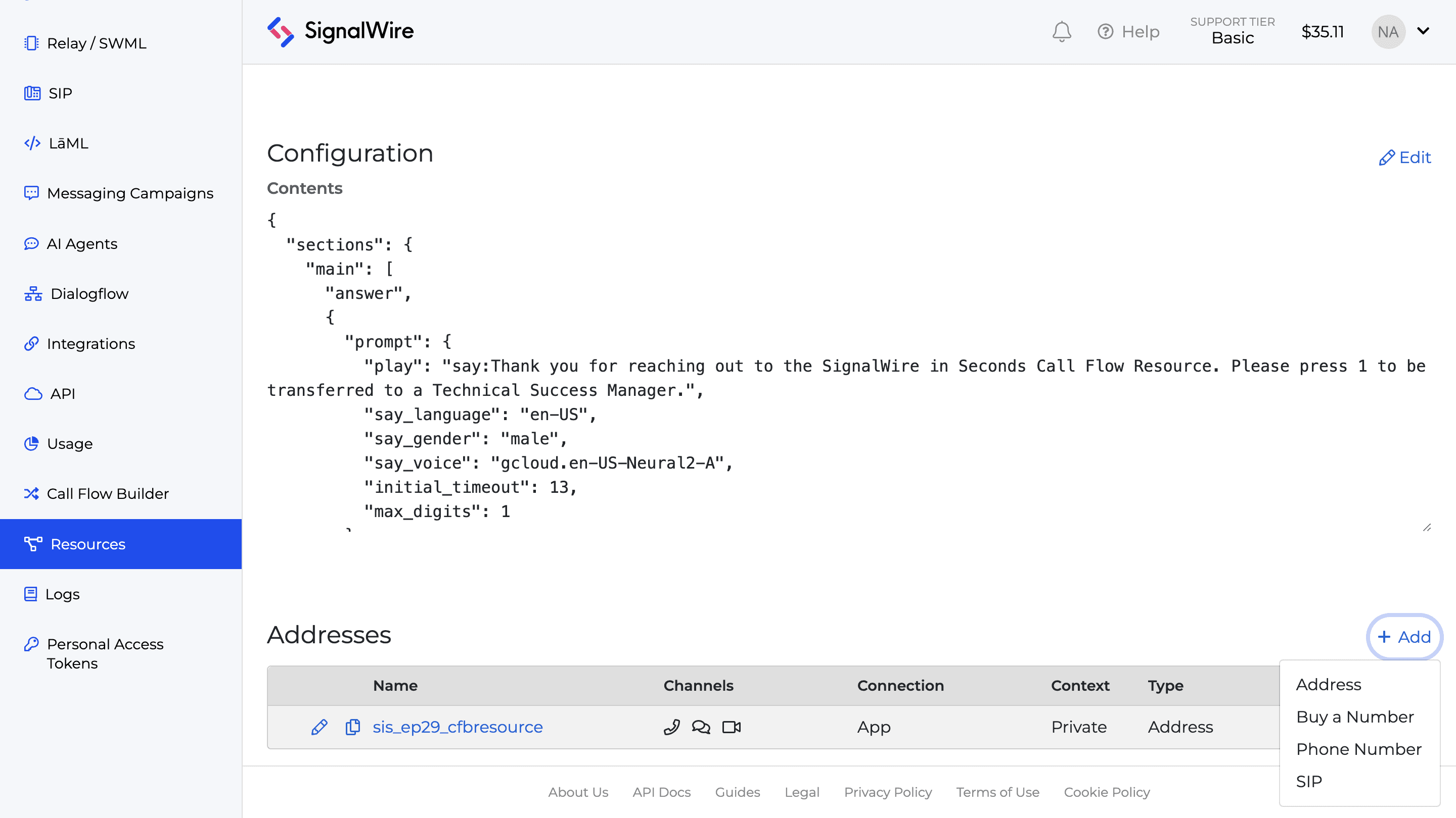

Every resource comes complete with a unique identifier called an address. Addresses streamline development across Call Fabric by standardizing how different communication components interact, allowing seamless routing across different mediums. These addresses allow easy assignment and reconfiguration of resources, simplifying management as businesses grow or change.
Contexts
Addresses consist of a context and a name. Likewise, SignalWire Spaces are bound by a pair of contexts: public and private. A public context is accessible by anyone, while a private context is only reachable via Subscribers. These separate contexts help to promote the structure and security of communication workflows.
Assigning a Resource
A resource may be assigned to an address, a phone number, or a SIP domain app by navigating to the bottom of the selection’s page. Resources are malleable, allowing assignment to multiple addresses. Further on in your development, these addresses can be reconfigured or removed at will.

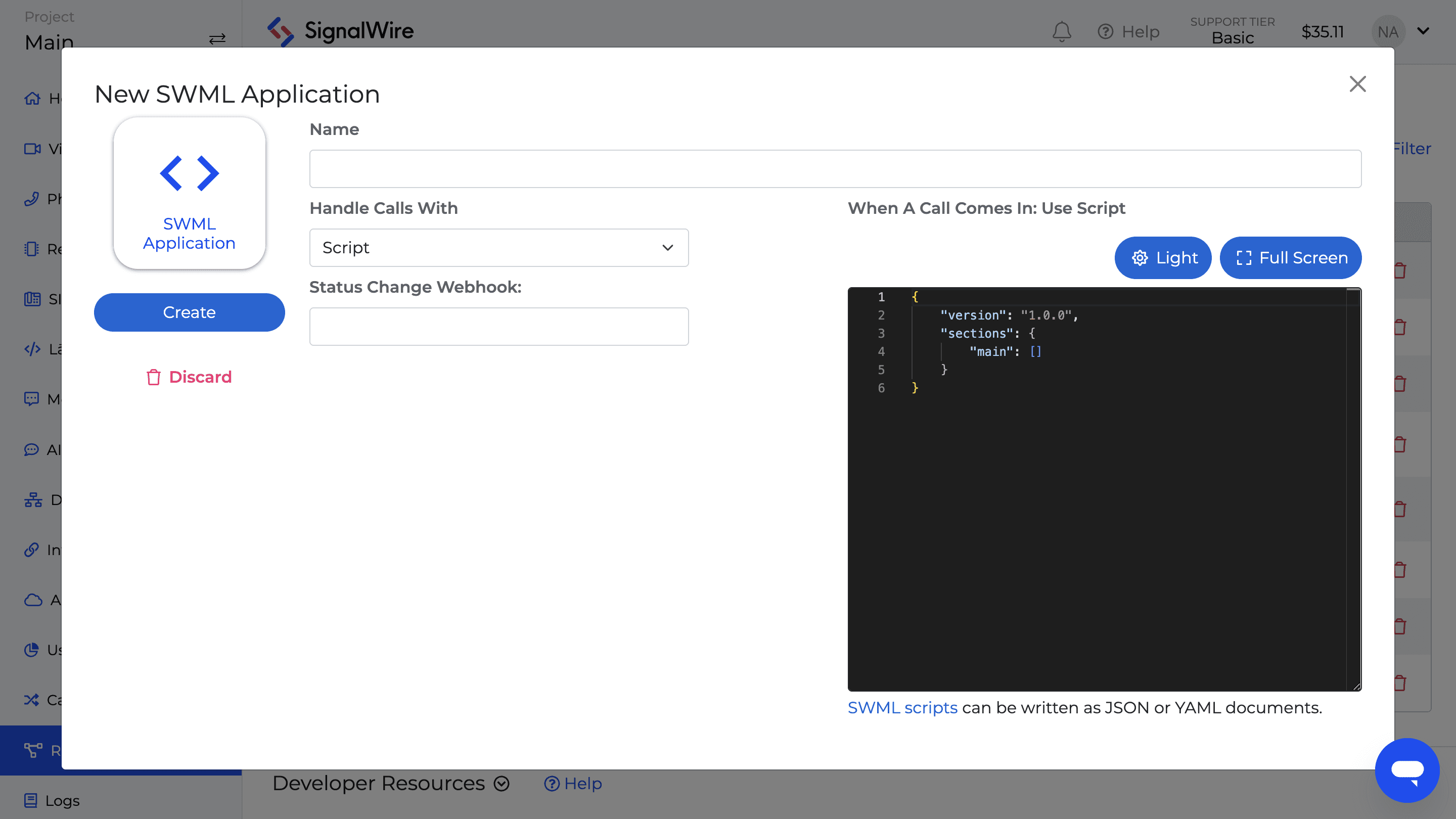

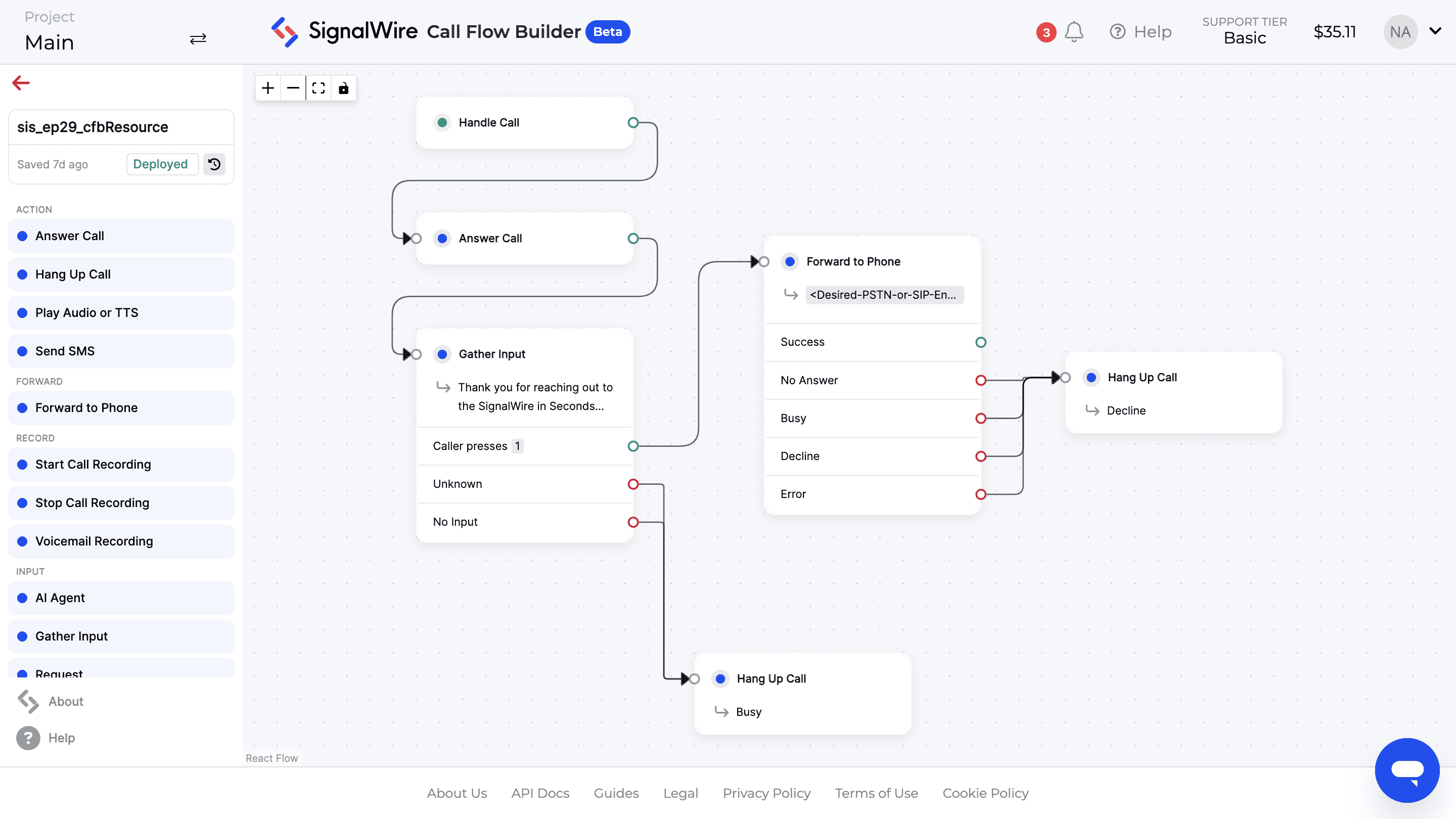

Our demonstration of Call Fabric begins with a Call Flow resource. Using Call Flow Builder, you can create IVR effortlessly with an intuitive visual UI. The Answer Call, Gather Input, Forward to Phone, and Hang Up Call nodes enable you to design a fully-functioning call flow application in just minutes. Once setup is complete, press the deploy button, and return to the resources overview page.
Resource example: SWML application
The second resource example in our demonstration is a SWML application. Coinciding with the rollout Call Fabric are a few quality of life improvements for our Space UI: a dark mode toggle for the SWML editor, and an auto-formatting feature reminiscent of popular IDEs. In addition to auto-completion of SWML’s methods and parameters, YAML and JSON script validation are also primed for a future release.
