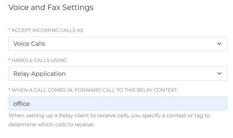

Log in to your SignalWire Space. From the Phone Numbers section, you can buy a new phone number. You will need at least one number to make and receive calls. After you have acquired a number, open its settings by clicking on “Edit Settings”. Scroll down until you reach “Voice and Fax Settings”, as shown in the next figure, and configure it to:
  • handle incoming calls using a RELAY application,
  • forward the call to the “office” RELAY topic
The Voice and Fax Settings pane.
Voice configuration setting for handling incoming calls.
Topic
In RELAY V4, a topic is a named scope that allows you to organize and categorize your resources. When you configure a phone number to handle calls with a RELAY application and specify a topic, all calls to that number will be delivered to RELAY clients listening on that topic.
