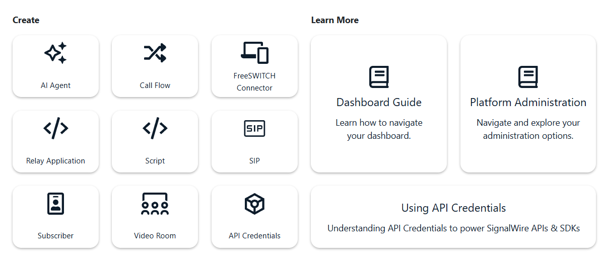

To start any project with SignalWire, I have to create a space by signing up. By clicking on 'Video Room' in the dashboard, I can find the options for building a programmable video conference. Because I have very little coding experience, I’m going to go with the first option: "UI Included."
From here, I’ll choose a room name, and when I create it, the settings for the room should load.
