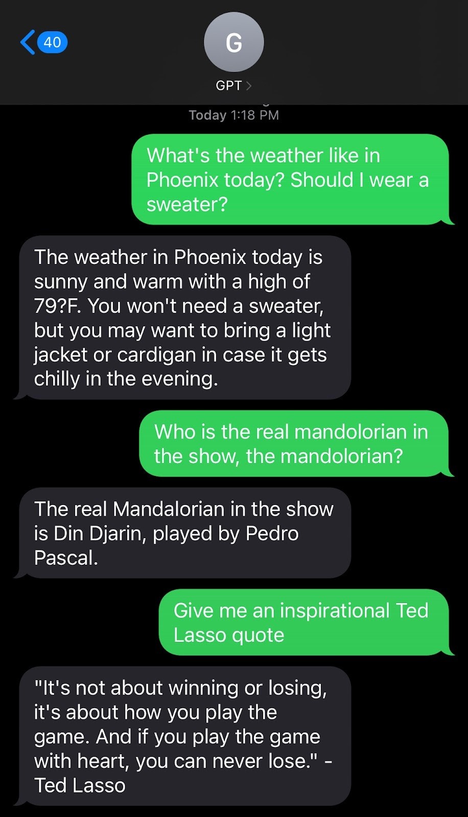

In this post, we will walk through building an AI-powered Textbot using SignalWire and OpenAI’s ChatGPT. This code snippet creates a textbot that can receive text messages from users and respond with a message generated by ChatGPT, or it can generate an image based on the user's request.
You can find the source code on SignalWire’s Replit Live Code Repository or test it out by sending an SMS message to +1 205-796-6268.

Now you can text the OpenAI bot from any cell phone or personal device. By using SignalWire and the OpenAI API, you can easily implement an AI-powered chatbot that can respond to customer queries, generate personalized content, and provide timely and efficient services.
