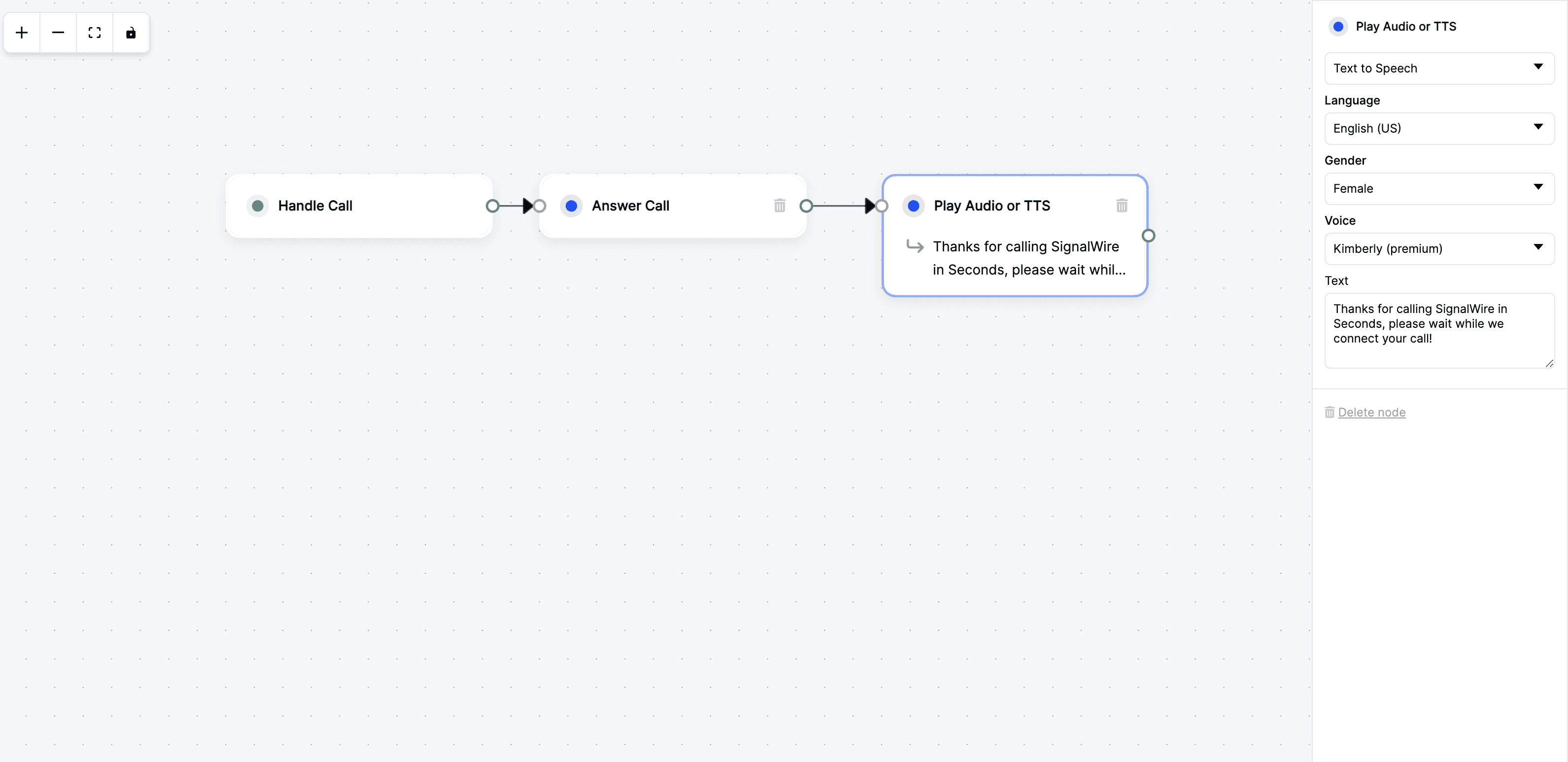

Setting up the call flow

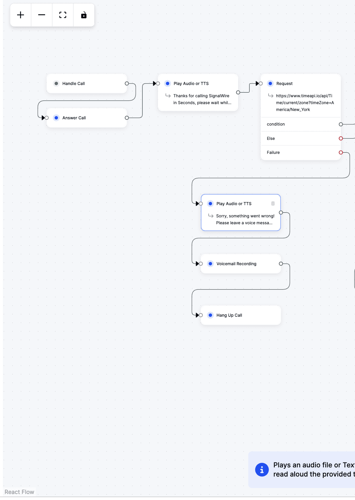

Start by heading to the Call Flow Builder tab within your SignalWire Space and initiate a new call flow by clicking on ‘Add New. Upon saving, the canvas will present the initial 'Handle Call' module.
To provide an immediate response to the caller, link the 'Answer Call' module to the 'Play Audio or TTS' (Text to Speech) module. This step ensures that every caller is promptly acknowledged as their call enters the system.

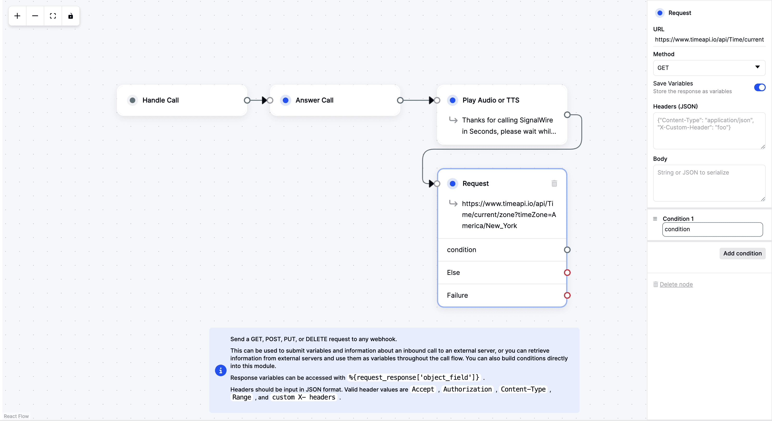

Implementing the Request Module
Next, configure the Request Module to verify if the call is incoming during business hours. This is achieved by connecting it to the Time API.
Note: The Time API offers real-time data on the current time based on a given timezone. Dive deeper into its capabilities on the Time API official website.
Set the method to ‘GET’, to retrieve information. In the "Save Variables" section, toggle on "Store the response as variables." This action ensures the data fetched from the Time API is stored for later use in the call flow.
For this API request, headers aren't necessary, and because it's a GET request, there's no need for a body.

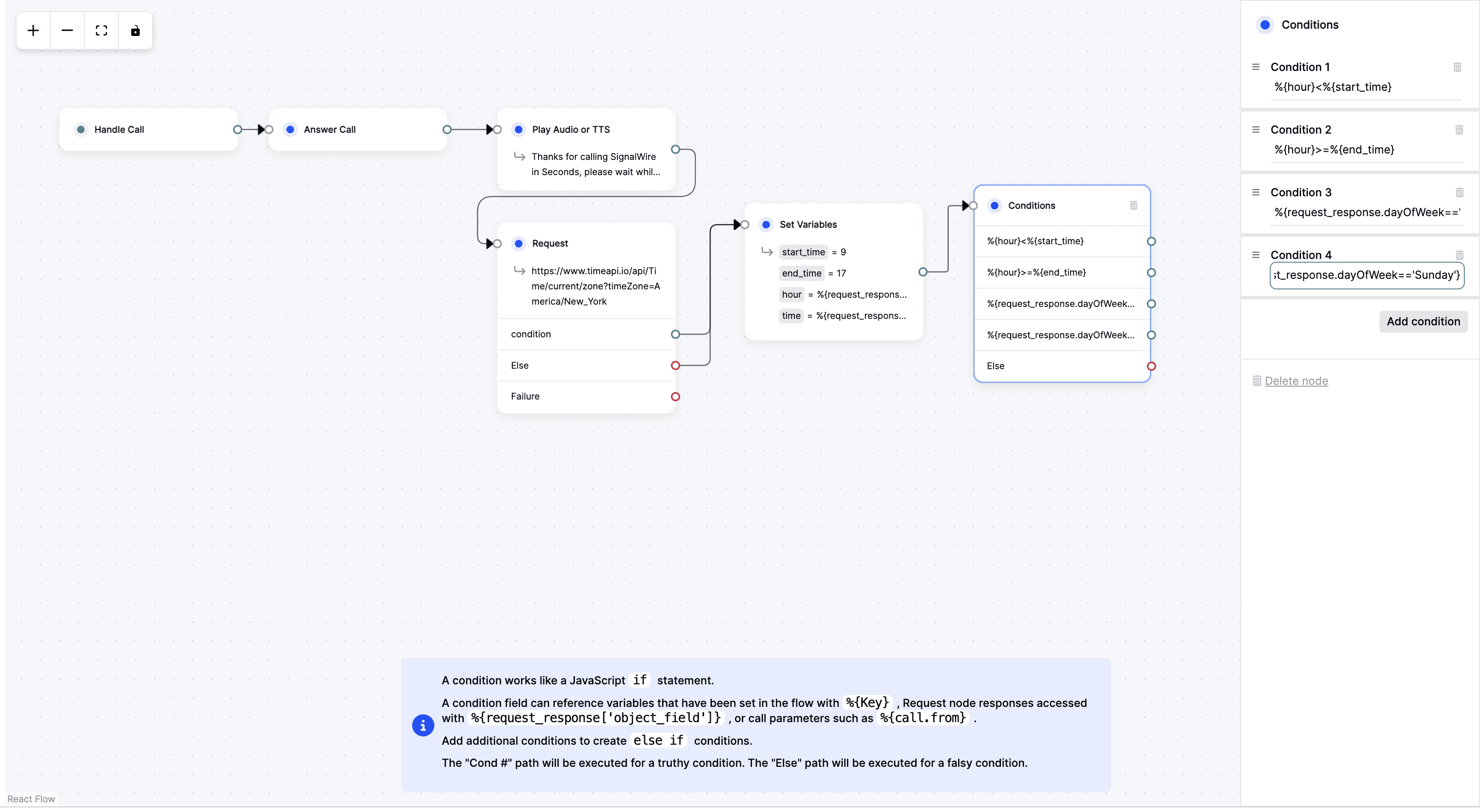

The "Condition" section is where we apply logic to the fetched data. Instead of writing out conditions directly within this module, link to predefined variables.
These variables hold the logic that determines whether the call is within business hours.
Remember to consult the SWML documentation if you’re ever in doubt about what to include in the Request Module.

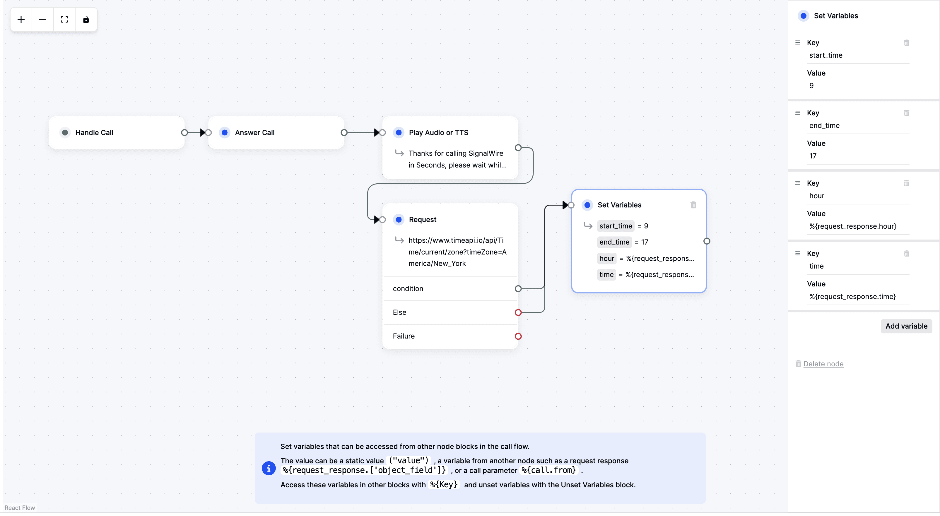

Set variables
In the Call Flow Builder, the "Set Variables" module plays a pivotal role in defining and managing data specific to a call flow. Here's a breakdown of the variables we've set up for our use case:
  • START_TIME: This variable marks the beginning of business hours, set at 9 AM.
  • END_TIME: Denoting the end of business hours, this variable is set to 17, which in the 24-hour format used by our Time API translates to 5 PM.
  • HOUR: This variable dynamically captures the current hour from the API's response. It's fetched using the SWML syntax %{request_response.hour}, allowing us to pull real-time data directly from the API's response.
  • TIME: Similarly, this variable fetches the precise moment the API is accessed, giving us the current time in the format "HH:MM". This is retrieved using the SWML syntax %{request_response.time}.
With these variables, we can craft a custom experience for the caller, ensuring they receive the right response based on the time of their call.
Conditions
The conditions we set in the Call Flow Builder are the backbone of the dynamic call routing. They determine the path a call will take based on real-time data. Here's how we've structured our conditions:
  • Condition 1: Check if the current hour is before the office's start time, with the SWML syntax %{hour}<%{start_time}.
  • Condition 2: This condition verifies if the call is being made post business hours, %{hour}>=%{end_time}.
  • Condition 3: Here we set a condition that checks if the current day is a Saturday using the API's dayOfWeekresponse, %{request_response.dayOfWeek=='Saturday'}.
  • Condition 4: Similarly, we've set another condition to verify if it's a Sunday.
With these conditions in place, we can ensure that callers are routed appropriately based on the time of day, whether it's to an agent or to a voicemail system.

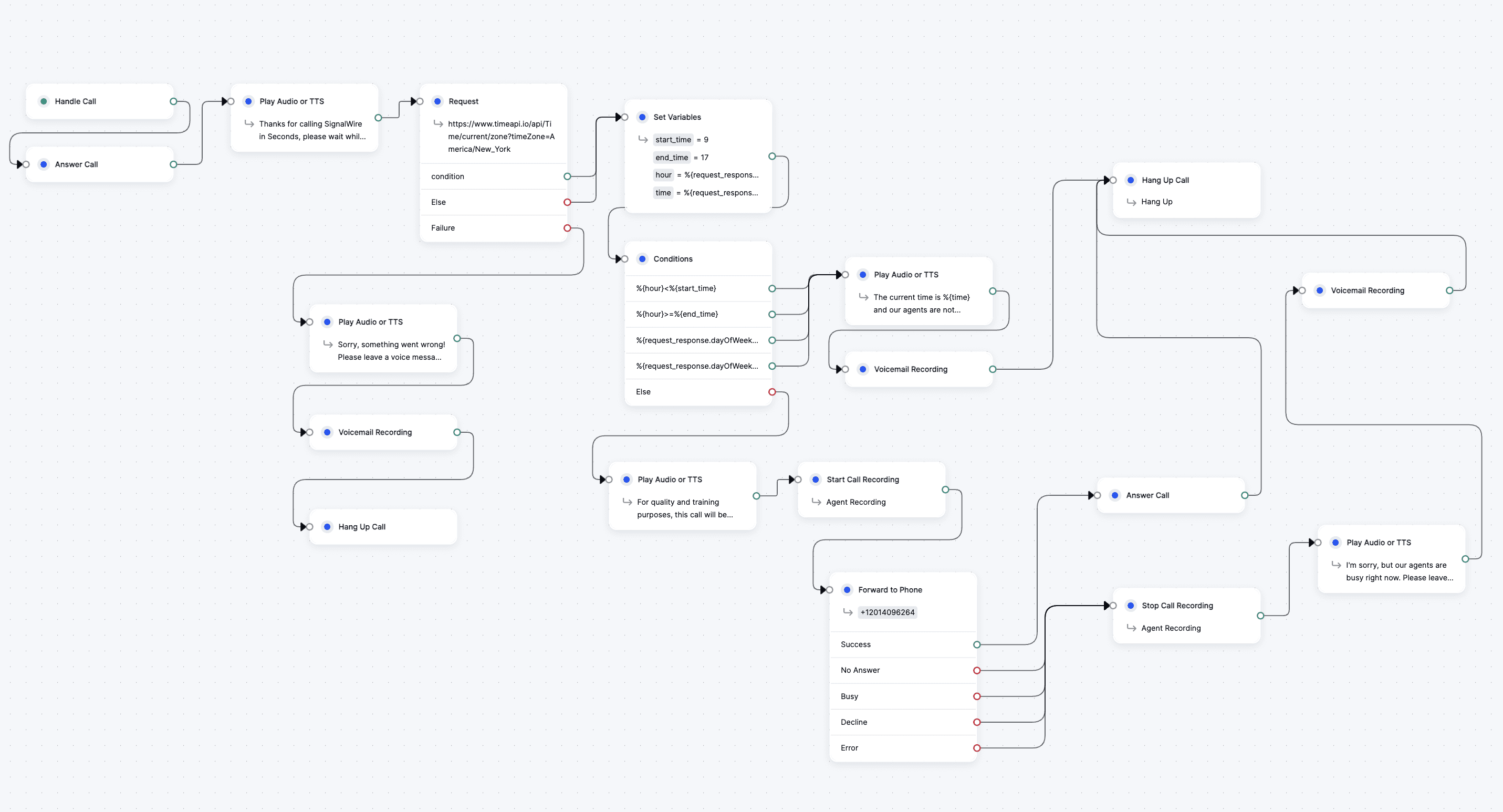

Caller experience based on conditions

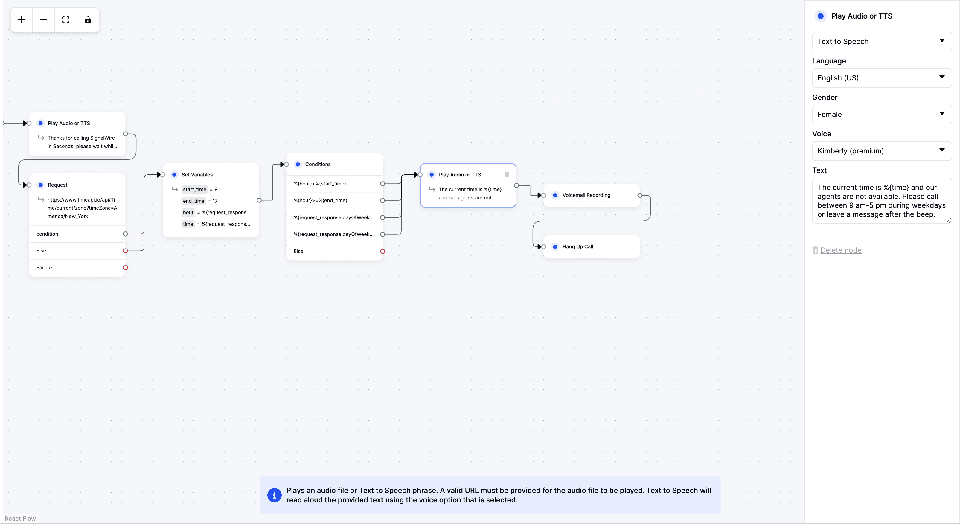

If a call comes in over the weekend, the caller is greeted by an automated message generated using the Text to Speech (TTS) module. This message is dynamic, leveraging the time variable from our Time API request.
Following this greeting, the Voicemail Module is activated, allowing the caller to leave a message.

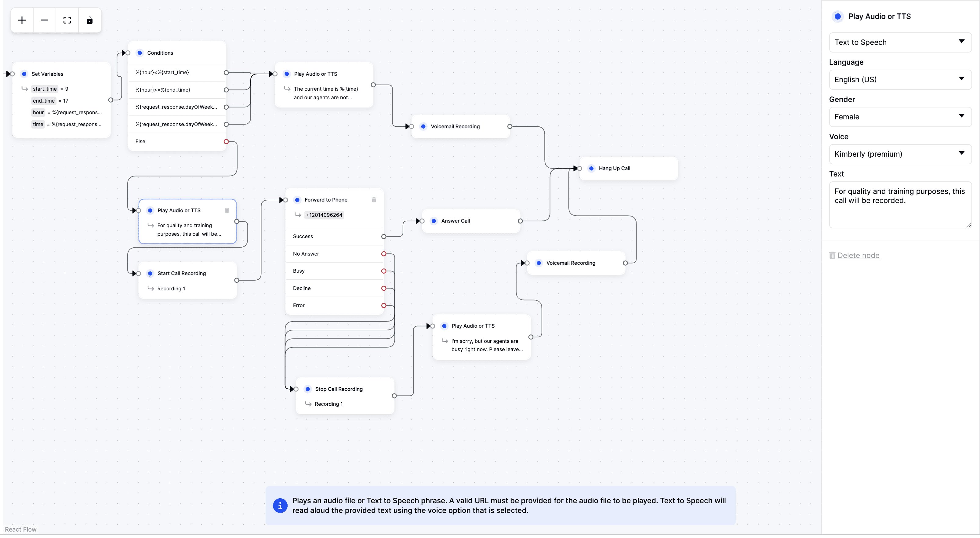

If someone calls during business hours, they're informed via a PlayTTS module that their call will be recorded. After this brief alert, the Forward Phone Module is triggered, setting the call to be routed to a live agent's phone number.
If the call doesn't connect to an agent, the Voicemail Module is activated, prompting the caller to leave a message.

Handling errors
In any call flow, it's crucial to anticipate and handle potential errors. This ensures a smooth experience for the caller, even when things don't go as planned.
In the event of an error or unexpected response within our Request Module, we've set up a series of fallback actions:
  • Play TTS: This module will inform the caller of an issue or provide a relevant message.
  • Voicemail Recording: If necessary, the caller can leave a message, ensuring that their concerns are captured even in the face of technical issues.
  • Hang Up Call: After the necessary information is conveyed or recorded, the call is ended.
