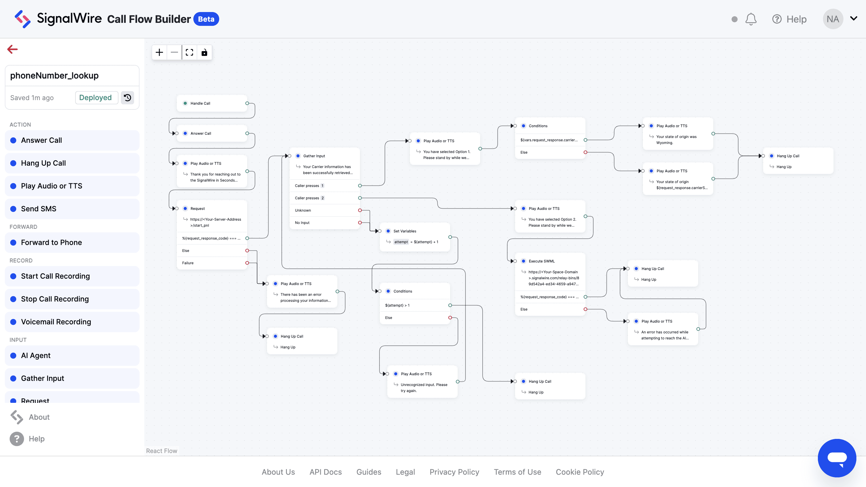

Contextual IVR routing with Call Flow Builder
We’ll begin by employing SignalWire’s phone number lookup REST API endpoint to determine the inbound caller's general location (based on the origin of their phone number).
Call Flow Builder helps developers navigate the complex intersection of telecommunication and geolocation, whether you’re charting a course for travel guides or emergency dispatch services to create a spatially-aware IVR using an intuitive drag-and-drop interface.
The Request node
The Request node is your avenue to accessing external data in your call flows. With support for HTTP methods like GET and POST, this node allows you to make requests to public URLs and use the response data during subsequent instructions.
Expanding base functionality with SWML expressions, such as ${call.from} and ${request_response_code}, the Request node allows developers to create complex workflows with little additional coding.
Phone number lookups
The call flow for this wayfinding application starts with a link to the first endpoint built for our Node.js server, `/start_pnl`. There, we’ll leverage SignalWire’s REST API to execute a phone number lookup of the inbound caller.
When a call enters our IVR, the inbound phone number is automatically passed from the IVR to the server using a custom header. The logic contained in the endpoint then normalizes the phone number format for the lookup and generates a query responsible for retrieving details like the caller’s city and state.
This data is logged to the console for real-time monitoring, and returned to the Call Flow Builder as a JSON response, informing downstream components of the caller's geographic context.

The Conditions node
Acting like a JavaScript `if...else` statement, the Conditions node provides call flows with multiple routing scenarios. In this scenario, routing based on the origin state retrieved from the PNL furthers our concept of a travel agency.
Evaluating logical expressions, such as `${vars.request_response.carrierState === 'WY'}`, sends callers from Wyoming (WY) down a custom path, while defaulting to an "else" path for calls from other states. This workflow flexibility offers a streamlined call experience for users who prefer to reach a specialized agent.
The Execute SWML node
Finally, the Execute SWML node passes the inbound caller to an AI travel guide named Carmen by executing a remote SWML document which hosts her makeup. Critical variables collected earlier in the flow, like `${request_response.carrierState}`, are also transferred from the call flow to the target SWML script.
These variables remain accessible throughout the script’s execution, ensuring that Carmen can provide personalized guidance informed by context associated with the caller’s prior interaction with the IVR.
