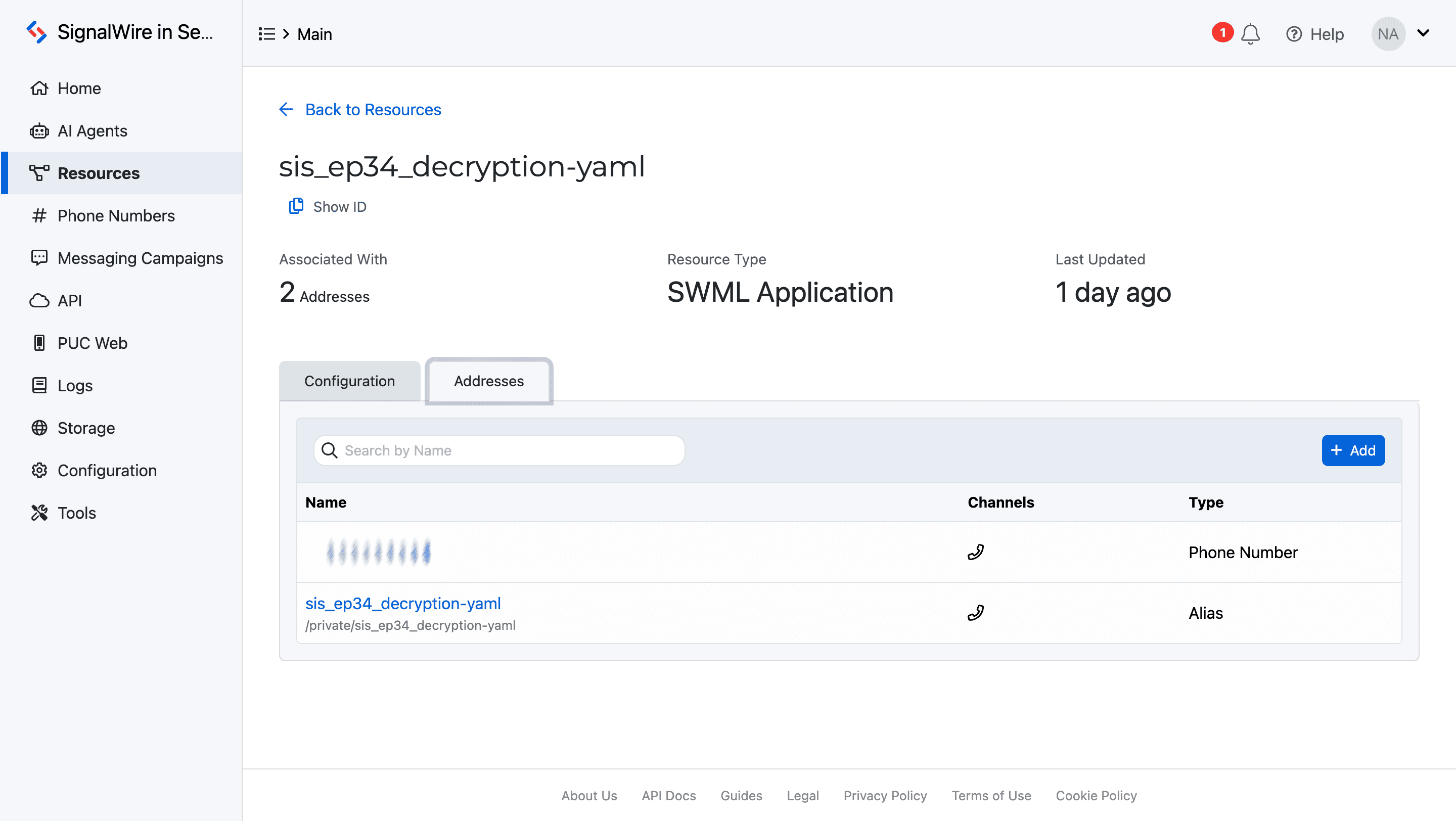

Configuring your phone number
Before deploying Fleming’s SWML script and your RELAY v4 messaging application, associate them with a SignalWire phone number.
A resource may be assigned to an address alias, a phone number, or a SIP domain app by navigating to the Addresses tab within the resource itself. Resources are malleable, allowing assignment to multiple addresses. Further on in your development, these assignments can be reconfigured or removed at will.
