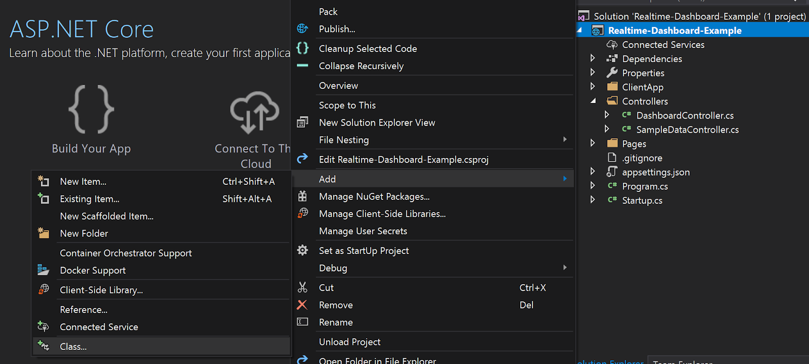

Step 3 – Right click on the folder in “Solution Explorer” and select “Add Controller”. When prompted select “API Controller – Empty”

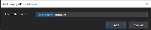

Step 4 – Name your new controller “DashboardController”

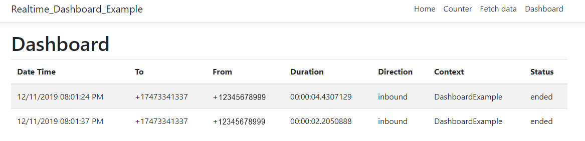

You will see we defined Dashboard(), when this is called it will provide the DashboardModel to the front-end in this case React for rendering. This will return a json object containing all the relevant data when you hit the endpoint http://localhost:53400/api/Dashboard.
Now let’s setup a react component that will display our data in a basic table.

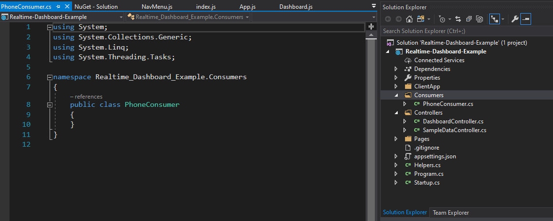

Now create a folder in your project called Consumers, and add a new class called PhoneConsumer.cs to the folder.
Now let’s work some magic...
First we need to inherit from the generic Consumer.

And voila! Now we can test. This is just one example of what you can do, so please continue to play around and reach out to us on our Slack Channel if you have any questions.
