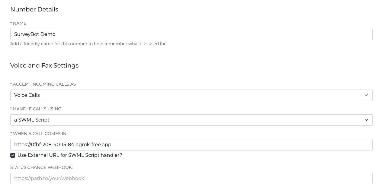

Lastly, you will want to configure your SignalWire number to point to the ngrok URL that we created.
In your SignalWire Space, navigate to Phone Numbers and edit the number you’d like to use for this example. Set the call to be handled as ‘a SWML Script’ and paste in the Forwarding tunnel url from NGROK that was established earlier.
set surveybot for SWML script
Then start the script.

How do you connect a SignalWire phone number to the SurveyBot?
Configure the phone number to be handled by a SWML Script, then paste the ngrok forwarding URL as the SWML webhook so inbound calls execute the SurveyBot flow.
