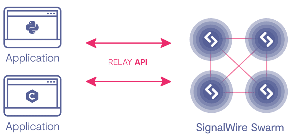

RELAY is the next evolution in real-time communication APIs. It's a real-time web service protocol that provides for persistent, asynchronous connections to the SignalWire network.
RELAY brings advanced real-time capabilities like real-time event monitoring functionality to the developer, without the need for markup language interpretation or latent REST responses. This is a game-changer for developers.

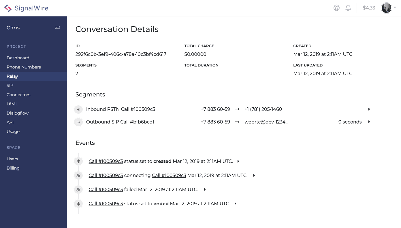

Using the SignalWire Dashboard

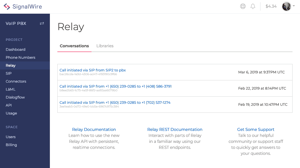

In the SignalWire dashboard, you will have the opportunity to see your RELAY activity. Here we can see a few SIP calls and some that also touch the PSTN:

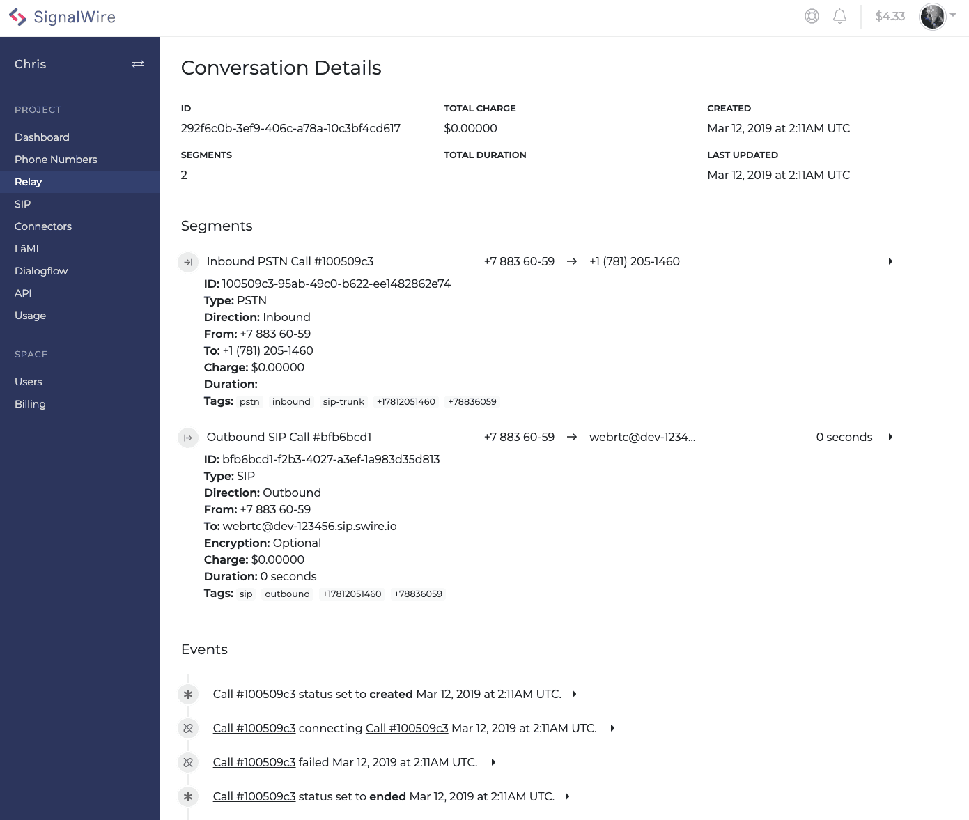

If we click on the call thread we can see more details on the conversation, including a summary, segments and events:
We can expand the segments and see the detail in each segment:

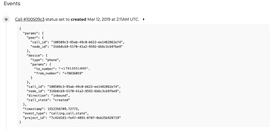

Let's have a look at the events. In this first example we see a Call Creation event:

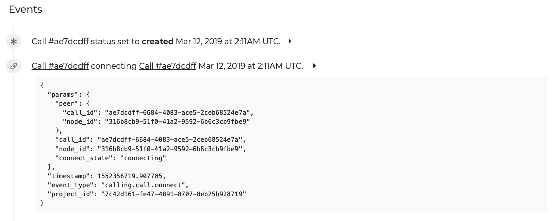

Next is the Call Connection event:
