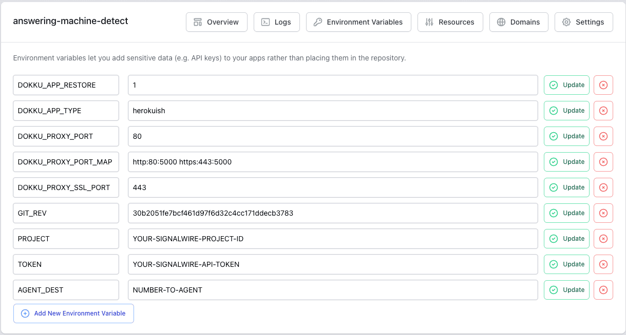

The app requires 3 different environment variables to be set in order to run. The environment variables are:
  • PROJECT: Your SignalWire Project ID
  • TOKEN: The API token associated with the SignalWire Project ID above
  • AGENT_DEST: The number or destination that calls should route to when a non-machine (a human) is detected.
You can set these variables one of two ways:
  1. If available, set them via the Dokku UI in the Environment Variables tab for the app.
  1. You can alternatively add the variables via the CLI of the Dokku instance:
dokku config:set PROJECT=YOUR-SIGNALWIRE-PROJECT-ID
dokku config:set TOKEN=YOUR-SIGNALWIRE-TOKEN
dokku config:set AGENT_DEST=NUMBER-TO-AGENT
The application needs to be restarted once the environment variables have been added.
